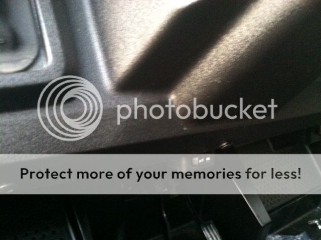

Finally got my winch installed. The KFI mount is super! I put the rocker switch right under the steering wheel. There really isn't a good place for the solenoid, so I removed the tool kit and put it in that hole. I saw a winch installed at the dealer and they put the solenoid under the middle section under seat, seemed WAY to hot an area for it. Directly over exhaust. Under the hood would have been good, but would have needed longer wires than was supplied in kit. Easiest keyed-on wire for me to tap into was the one for the 12v accessary plug under hood. Winch is Superwinch Terra 45.

Thanks for the pics! Especially the tip on the solenoid. Now, please get it profoundly stuck, and winch it out and let us know how the mount does! :D

Been waiting for these so i can decide if i want the KFI. How about some more pics...maybe from the side?

Here's a few more pics at different angles.
