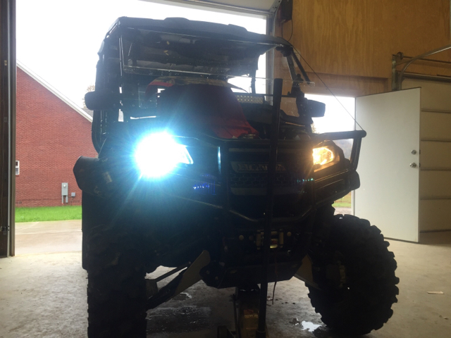

The stock lights are super dim. I just wish we could easily pic the tint we we want when purchasing LEDs and HID's. It's easier to find the right color in HID but not the LEDs unless you want to spend a ton.
The only reason we ask for pics and brand is so the next guy knows what to buy and what to stay away from. No one needs to buy the kit that I have.

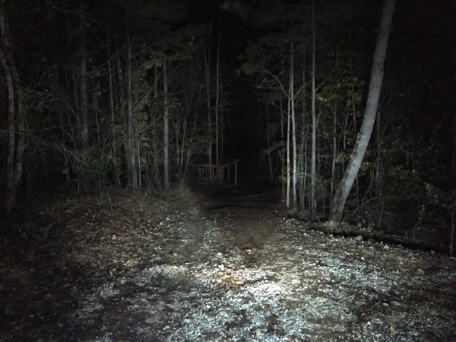

Do you have a beam pattern picture? I care more about how the light performs instead of how the front of the vehicle looks.

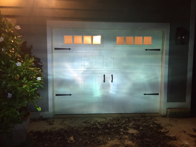

My HID kit looked "cool" just like yours pictured but the light output was terrible. This is the OPT7 kit. Here are some pics....
Cool blue may look good but it's less effective for night vision. Our eyes are built for 4300k not this 6000k
Left a big hole in the middle
Scattered light pattern
I usually go 5000 which seems to be pretty good in the woods. Mine were drastically better than that too I've been thinking about it and I think it's the length of the bulb that affects the pattern I think there's a certain length bulb that works good because I've changed Hids into everything I own from my dirtbike Snowmobile's sxs bus Polaris to my truck and my Lexus and always had good luck. Sometimes the pattern isn't quite as good as factory but the amount of light has always made up for it in every way But it would be really nice if people that do have HIDS can show pattern so others can know what to buy

I am surprised and disappointed to see that dark spot right in the middle field... That's where I would want more light.....
