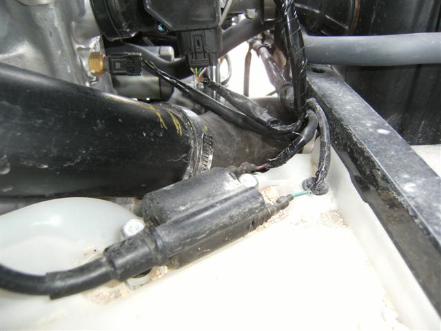

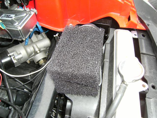

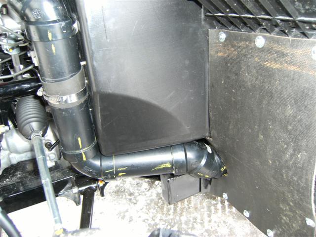

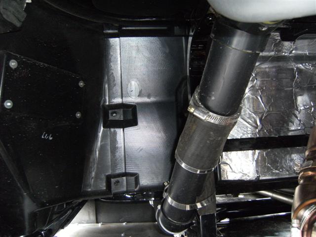

Made the snorkel out of 2" pvc and some 2" Rad hose. Most bends are either a 45 or 22.5 degrees.Only one bend is a 90. I have mine running along the outside of the frame on the drivers side and the air intake is right by the Rad cap. I used a filter right at the spot where it draws air. The pipe in that area is actually angled downwards so that if any rain or water gets into that spot it's not going to be running into the pipe. I used 2" rad hose in a few spots so that I can take all the pvc pipe etc: off if I want to. The 2" Rad hose is also used to go into the filter box. I put a piece of 2" pvc inside the Rad hose right at the filter box so that I was able to use a gear clamp to seal the hose to the Filter box. My first attempt was to run the pipe between the Skid plate and the floor but when I tried doing that I ended up with way to many bends etc: The way That I have it set up the Pioneer runs like its supposed to.
If I was to do this again I'd go and get some Air seeder suction hose rather then using pvc. This way there wouldn't be any joints or sharper bends,you could just run the hose from the filter box to where you want the intake. BTW the air seeder hose comes in different sizes so you could use a bigger hose if you want.
