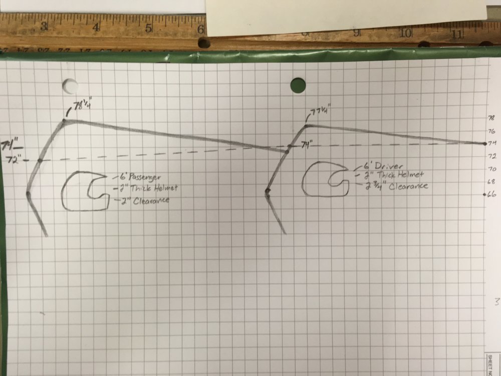

IMG 0307
Here it is to scale the best I could measure with each square 2". The dashed line was the best scenario I could come up with under 74", but at 74" to the top, that means I would be ducking or hitting the tube all the time getting in and out.

View attachment 30799 Here it is to scale the best I could measure with each square 2". The dashed line was the best scenario I could come up with under 74", but at 74" to the top, that means I would be ducking or hitting the tube all the time getting in and out.
Yeah I doubt you'd be happy cutting it that close. Hey now you have a reason for a shop right?! Lol
