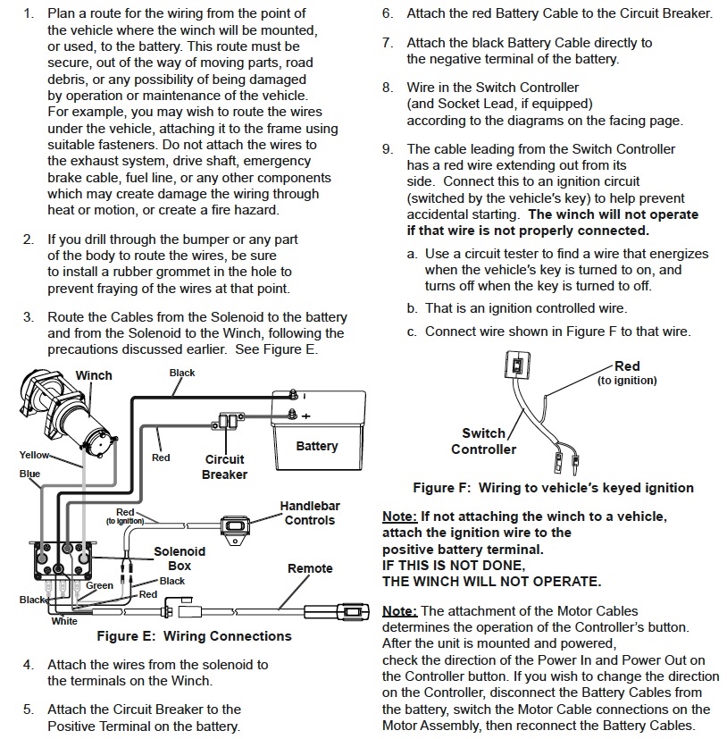

Here's a picture of the wiring diagram that comes with the Winch...
WinchWiring copy

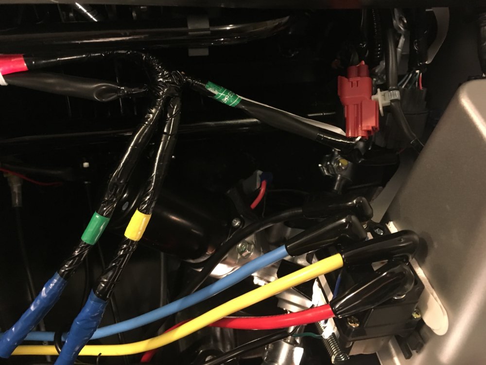

I have a viper winch and it was super easy! Two wires from battery to solenoid (red/black) then two wires from solenoid to winch( blue/yellow). And then the red "key on wire" plugged into the harness via bullet connector.
I did need to swap the cables to make it work because the yellow/blue were longer than the red/black to reach the battery under the seat all to the winch
IMG 2103
Reactions: dmcpeak
So now that I have the wiring harness- which wires do I attach to?
There's yellow, green, white & Red.
The wiring from the rocker switch only has the red- So I would assume red to red?
I think I did use the red one. It it should really matter. Mine came with blue tape on each of the 4 wires and when I took it off there were two wires within, one hot, one ground. I just touched my winch wire to. It's while the key was on and tried the winch and one worked, one didn't. I threw a bullet end on the red winch wire and stick it in the connector that was got and taped it up. I'll probably put some shrink wrap on it to make it water proof in the future but for now it works.

So I stripped the blue tape off the RED wire and it appears to only have one wire connected to the female bullet connector?
Is that right? If so I would only need to put a male bullet on the Rocker switch red and pop it in. Correct?
