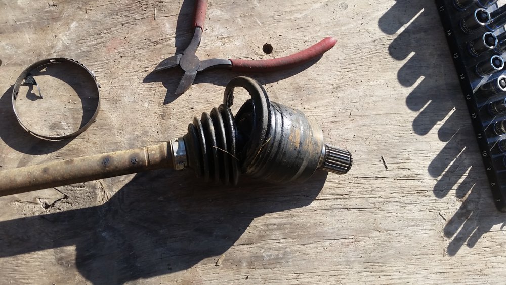

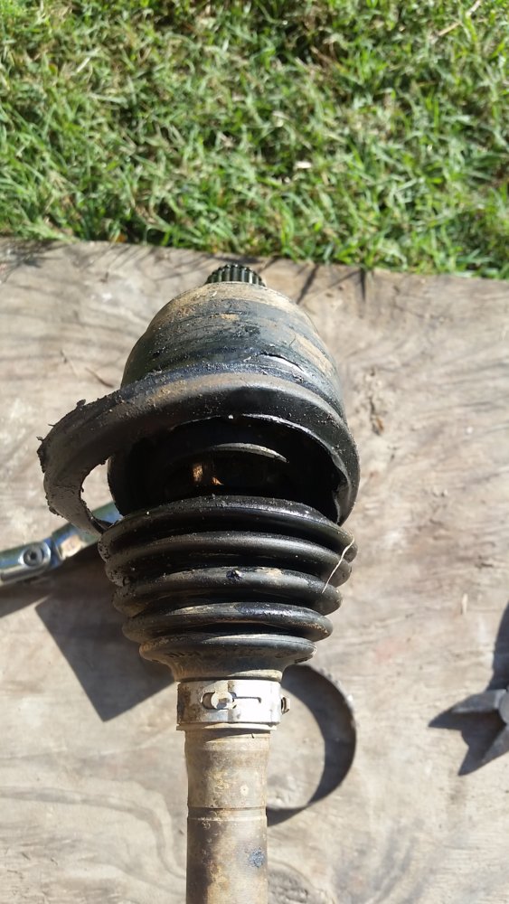

Anyone had an axle boot problems since the commander shock instalation?
Clean cut as if some one used a razor blade on it. LR Axle
View attachment 22771 View attachment 22772
That's interesting. I haven't had any failures of the boots yet *knock on wood* and I was actually more concerned about additional wear on the cvs resulting in failure. The boots felt like they had some more stretch left to them. The drop is the same as the drop on the strongmade lift kit and those don't seem to have any known issues with boot failure. The shocks do ride higher then the lift i compared them to so I would expect additional wear. I would be more inclined to think something got wedged in there and wore through as the axle turned.
