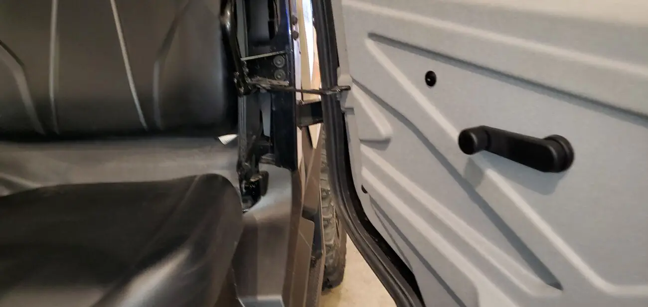

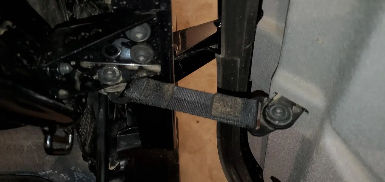

Or, you could cut that strap off there and just use the end fittings. Replace the strap with double sided "hook and loop" . . . that way you can adjust it however you like. If you find a setting you want and want to make that "permanent", you can put a zip-tie around the middle so the hook and loop can be removed unless you first cut the zip-tie.
