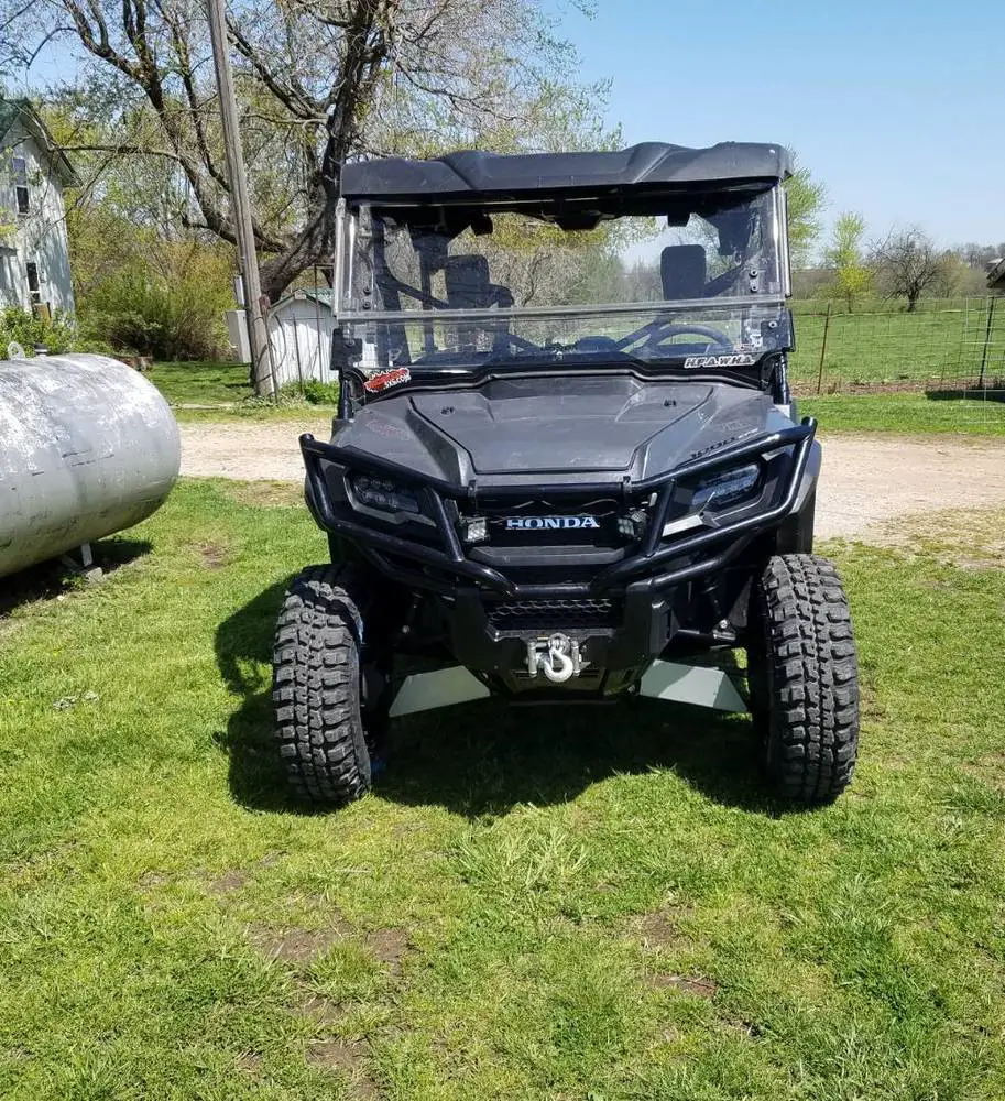

Think I'm 64" pioneer 1000-5
39,982
273,566
So 69.5
Yes, likely outcome.
What wheel offset and tire size? My P1K was 64" on front with 28x10x14 Roctanes on 6+1 STI HD3 rims, rear was only 62" with that setup too.

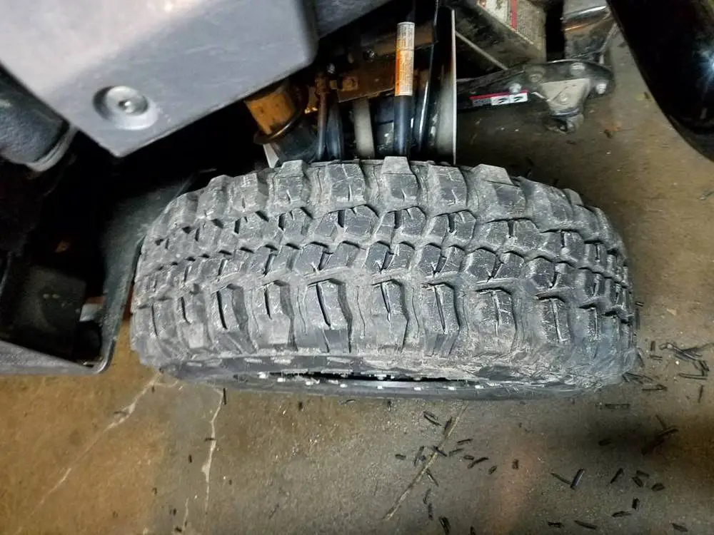

30mm offset hd9 and 235-75-15 .1"spacers in rear F844908fc78fd2fa6813bb0354bbb66a790bfb927a0cde164cd00a1c2b65fa9d3d3e1a3d43171b5447030af10a43f9a5

Well that's about as close as you can get, 30mm being just over 1 1/8" offset.
