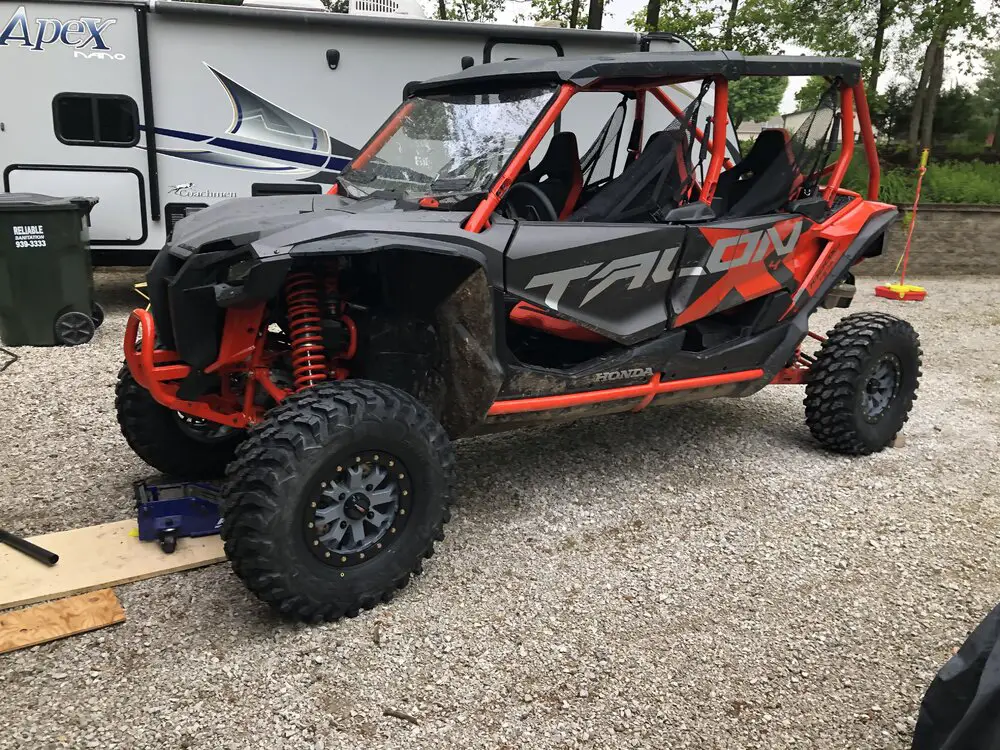

And for Remington, here's a pic with set of freshly installed 30s on beadlocks
Talon with 30s

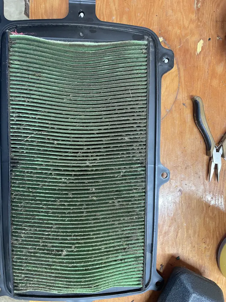

We’d still like to see pics of the filter that was dirty enough to keep the engine from running if you haven’t thrown it away, plz.
35,445
208,728
Unless I am not looking at this right....that filter is not dirty. I have 1000 miles on my filter in Tennessee trails. My last filter was 10x dirtier than that and still worked. Something doesn't seem right. But I am glad you got it back running!
Was thinking the same?
Reactions: Hometeam

Barely used. That will not cause your machine to not start.
There was (is) something else wrong. I wonder if a connector or wire is lose and you "knocked" it back in when you changed the filter. You may want to look at all the connectors to make sure that all the wires are fully inserted and the connectors are fully "locked" together.
Also check all your grounds (especially the ones under the driver seat) and make sure they are tight.
