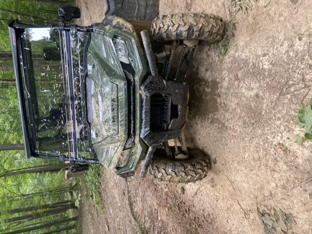

I just made one. All the ones I saw either individually or as part of a bumper were too high to be useful. I figure the 2022 versions will be too. I got a receiver from Harbor Freight and welded it to 6x6 1/4 plate and bolted it to a matching plate inside the bumper. The inner plate has a short clip angle to grab some support from the winch bracket. So far so good.

Front 2" receiver (winch option) allows rear winch deployment using jumper cables (cheapo route). No fancy connectors needed. I did something similar and ended up changing the jumper cable clamps. Will probably upgrade to a disconnect plug in the future.
