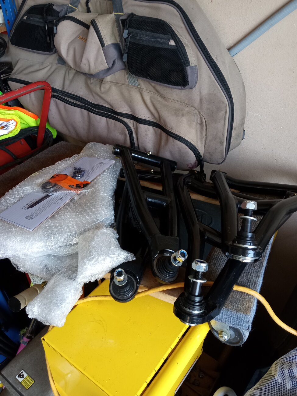

The 2022 upper A-Arm has 2 mounting brackets. The upper would need 2 mounting tabs instead of one long bar cross-member (See Pic). It's not SATV's fault. They do not reference the 2022 model. I took the risk. Will probably sell via eBay.

The current arms will definitely NOT fit the 2022 model. We knew there would be quite a few changes to the frame from Honda's little ads and updates to the 2022. For sure....
- New A-arms
- New Frame Stiffener
- New skid plate
- not sure about tie rods yet...but possible.
- not sure about axles yet, but they should still work...fingers crossed
We JUST got ours in here late last week. The guys already have it stripped down and have been scanning it all day.

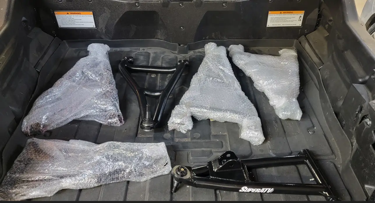

His original post is gone (deleted?), but I wanted to give a MONSTER sized 'Thank you' to @rudyeng for his generosity. These A-arms are now sitting in the back of my '21 P1K5 Deluxe, so it looks like I need to be ordering the rears from SuperATV soon. He even covered the shipping, which was substantial. All I can say is, muchas gracias!
@rudyeng, I'll be making that donation to St Jude Children's Research Hospital soon, and I am already planning on doing some type of pay-it-forward/similar for someone here on the forums when I have the opportunity.
