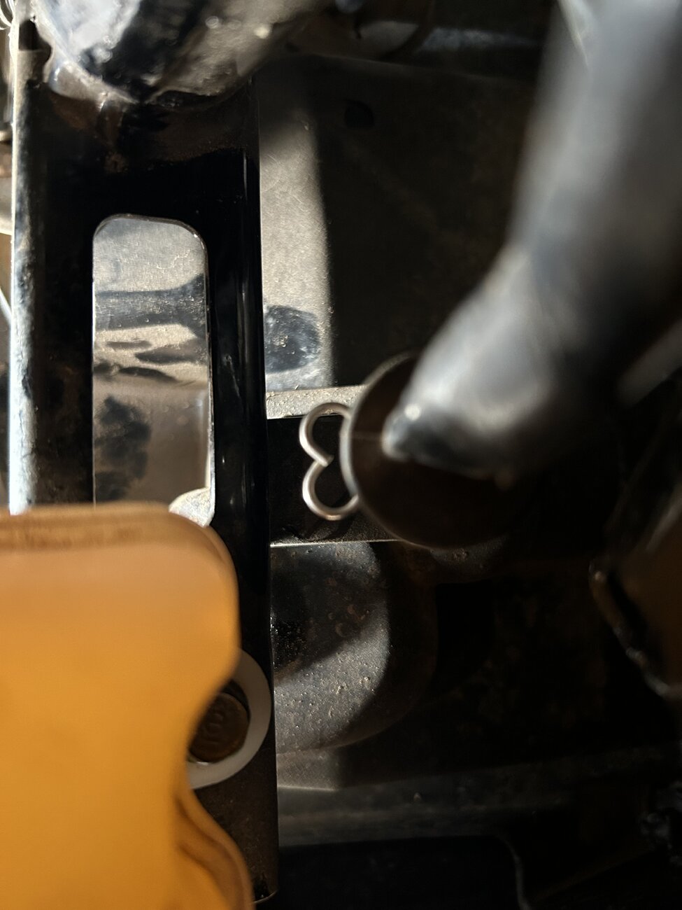

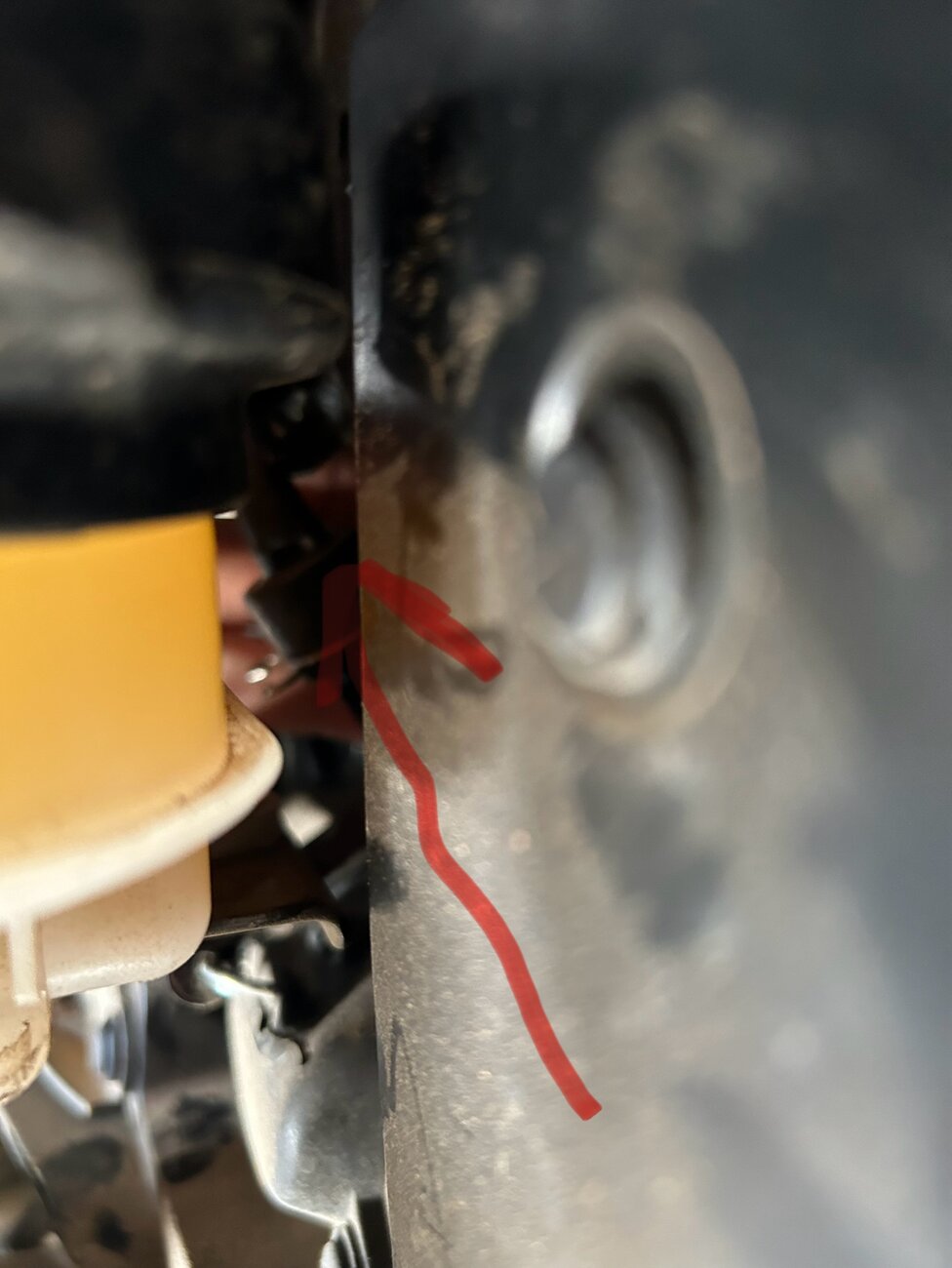

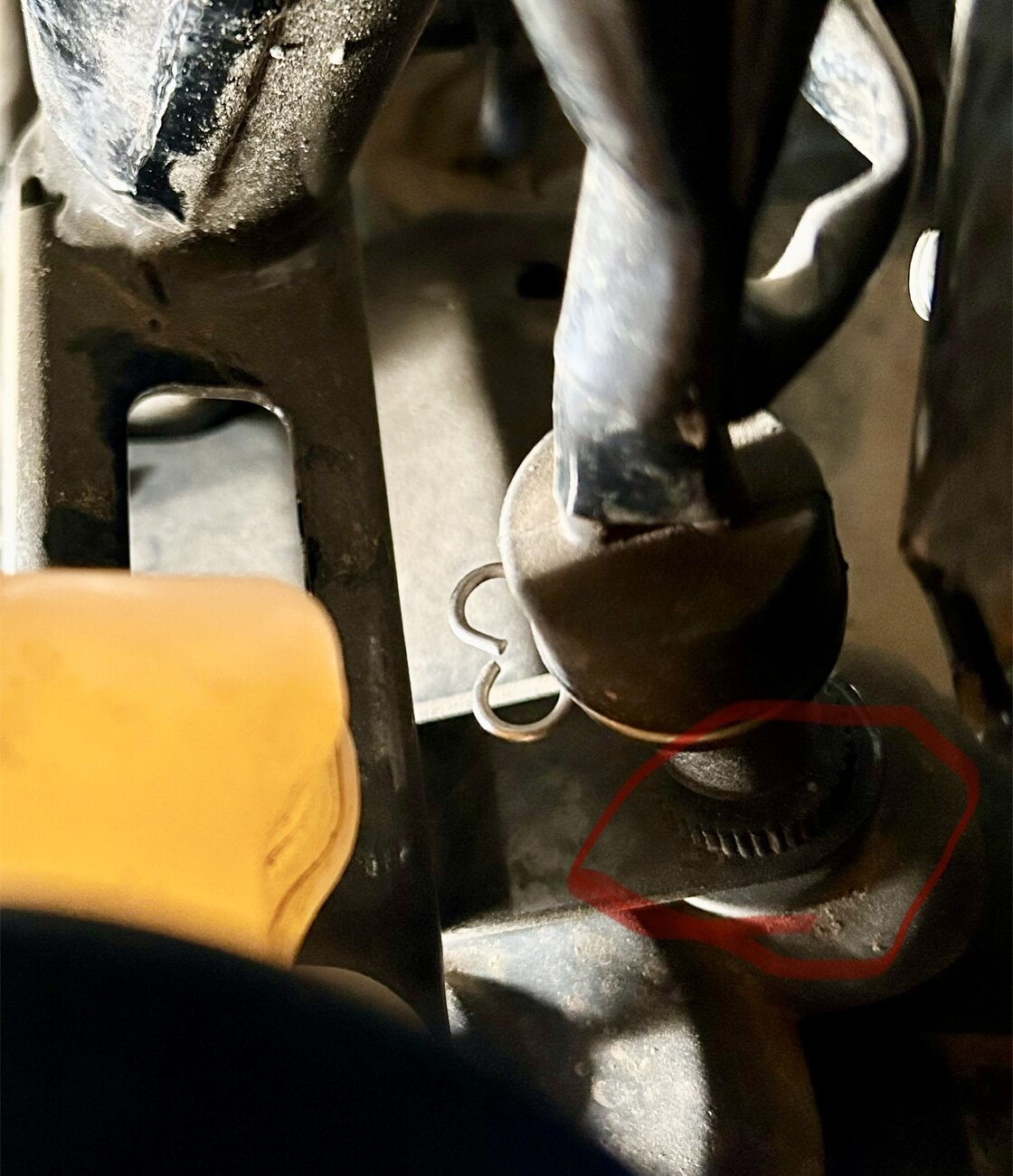

I was pretty sure it had something to do with the brakes because it stays off when I’m using the brakes a lot. Only seemed to come on when I’m driving on the street and not using brakes much. Someone on another forum said that it could be brake sensor out of adjustment. I found it behind the brake fluid reservoir on the drivers side in the wheel well. Looking from the front I adjusted the plastic stop knurled nut clockwise. Light is off for now but only time will tell if it stays off.
p.s.: you have to pull the switch up and out of the bracket to adjust.

They’re not but I adjusted it to where the lights come on just before I feel back pressure from the brakes engaging. Saw an instructional video on a YouTube for the adjustment (video had nothing to do with the I-4WD light ). We’ll see how it goes.
