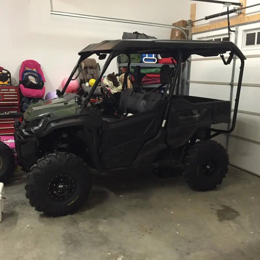

The 12" variant also runs small. I run 30x10r12 on all four. I'll get a measurement as soon as I get home. I absolutely love them. @joeymt33 is correct on everything, but my wheels, they are sti beadlocks.
This is the only picture I have on my phone.
IMG 3548

Oh yeah, I don't know why I thought you had the oem steel. I think it's smart to have the 12" wheel and get that extra cushion.

Thanks for the pics and info, much help.
Whats that metal piece on your upper front a arm?
I really like that setup, I assume it gives you the ability to rotate your tires, with the same size wheel and tire all the way around.
Did you use the itp lugnuts with those wheels?
How hard were the beadlocks to install?
Do you notice much gearing change with the taller tires?

The metal piece is the bracket for the strongmade lift. Being able to rotate the tires is definitely a positive to me. I do have 1.25" spacers on the rear to bring them out even with the front tires.
Three of tires slid right on the wheels with just soap and water. The fourth was a little more difficult. I had to use all my 230lbs jumping on it to get it on! Haha. Maybe I was just a little tired by then...
I didn't notice much change at all in the gearing, although, I didn't put many miles on it with the factory tires.
I measured the width before, not sure, but I believe it was 66"
