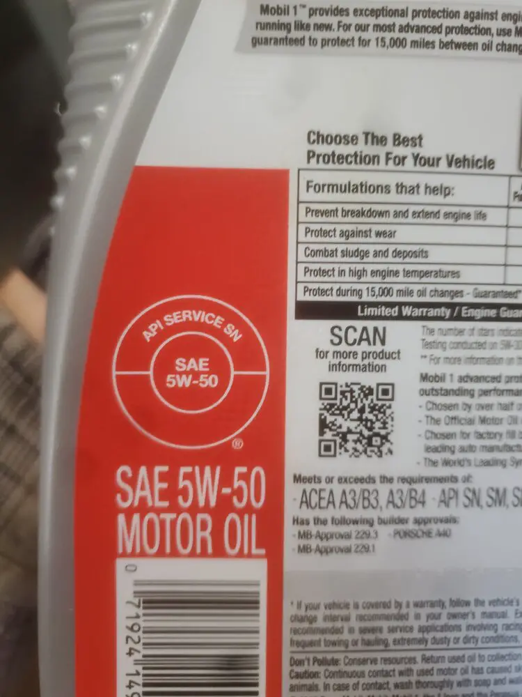

2021 01 021404233052438377098529597
Although it does not say energy conserving on the API logo. I did try it considering this fact but the tranny is definitely doing some weird things and shifting rough. I just did a test drive down the road and back. Gonna probably drain and refill with something else.

That is Definately NOT JSOMA compliant oil.
DOESNOT contain the additive REQUIRED for wet clutches
Continue to use & you WILL HAVE Transmission Problems. ( change ASAP )
1st. shifts different then Clutches start to slip & keep getting Worse lots of $$$$$$$$ out of the old wallet.
Correct oil & filter is cheap compared to trans repair or replace.
Oil you have is Main purpose is automotive .

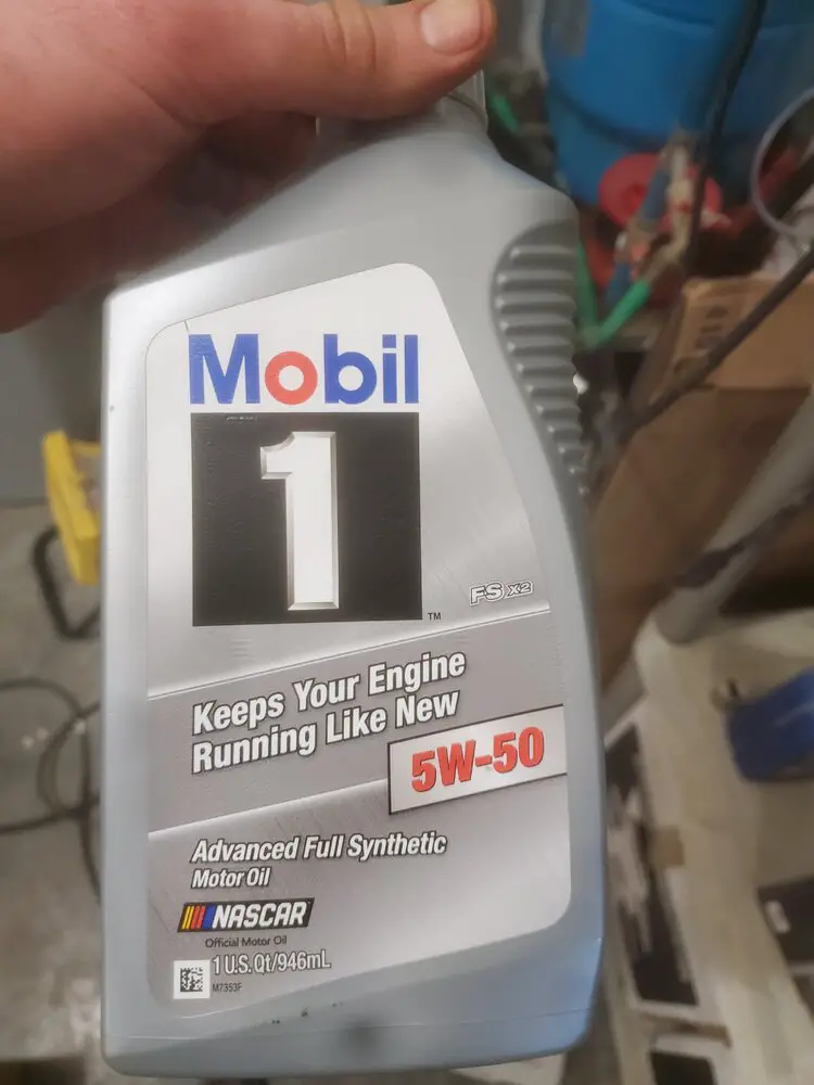

Here is what the front of the bottle looks like
No go on that. I kinda had a feeling it might not be. PoPo engines have no "clutch", so they can run it.
There are good and cheap alternatives. Wally worlds Supertech ATV/UTV synthetic is available in a 10-30 and a 10-40. Then there's Rotella T6 5-40. Both very good.
