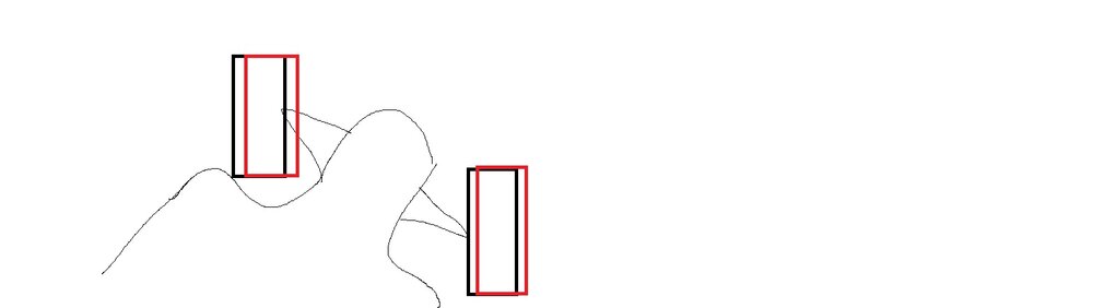

Oh man, drawing with my finger on this lap top using MS paint a'int the best, but maybe it is good enough for this LOL. The black would be more offset, the red would be less offset. shouldn't that help with the rubbing, not make it worse? Maybe I'm thinking about it completely wrong?

whoops, i messed up the right side (outside wheel), the red square should have been moved inward obviously. The left side tire in this picture is the problem though, and I think I have it drawn correctly?

Nice finger paint, but it doesn't account for the geometry involved governing the arc of the hub (ergo wheel & tire) as it pivots.
But go ahead and do what you want, you seem to have talked yourself into it.
Can't tell you how many dozens of Pioneer 1000 owners listened to Facebook experts that said 30" tires will fit with only a lift. (they don't) So $1000 in tires and wheels then another $600 in forward A arms it kinda clears. Then they had A arm issues, or to inexperienced to set camber properly on adjustable a arms.
My point being, just because someone says it clears no problem may not be using the machine in a manner where it may rub. A new tire mounted on the machine for a test fit is not the same diameter while running 40+ mph.

Oh man, drawing with my finger on this lap top using MS paint a'int the best, but maybe it is good enough for this LOL. The black would be more offset, the red would be less offset. shouldn't that help with the rubbing, not make it worse? Maybe I'm thinking about it completely wrong?View attachment 204488
You are correct, the Talon rubs just like you have it drawn and the offset moving the tire closer to the hub and away from the fender but you have your offset backwards. More offset moves the wheel/tire inward and away from the fender when you turn sharp.
Remember, 32" tires range from 30.5" to 32.5" so 32" may or may not rub depending on the tire. When someone says "mine doesn't rub with 32's", could be because his 32's are only 30.5".
Square type tread true 32" tires will rub no matter what offset. Rounded style tread 32" will rub less.
31" (if you can find something you like) should not rub and 30's don't rub at all.
50 mm offset (STI 6+1) wheels will maintain the correct front scrub and widen you slightly with 10" wide tires (45 mm offset System 3 wheels will also work great). You will need 40mm (1.5") wide spacers in the rear to even out the width.
If you want to run anything larger than 31's without rubbing, you will need forward sweep lower control arms.
