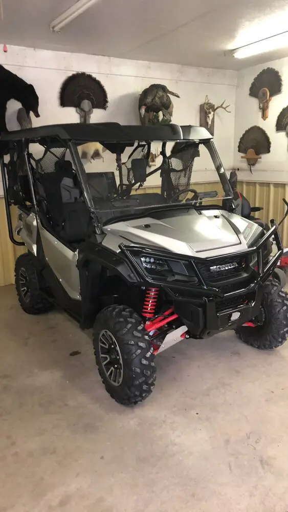

I have a 2019 Pioneer 1000-5 Limited Edition. Are the front and rear wheels the same size? I know the tires are not, just wondered about the rims. Thanks!
