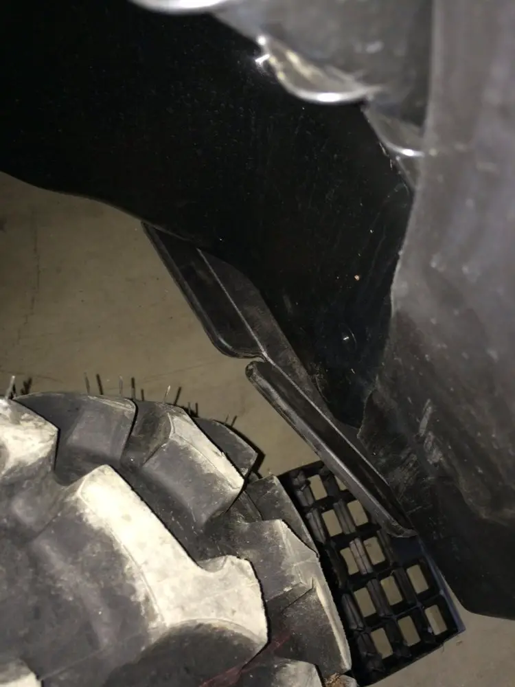

This is how it looks now. Almost 2 inches too long at this spot. I think the stock tires would rub too.

OK... You just wanting to bend it more. Heck. I'd try that and put a screw in it if you can.

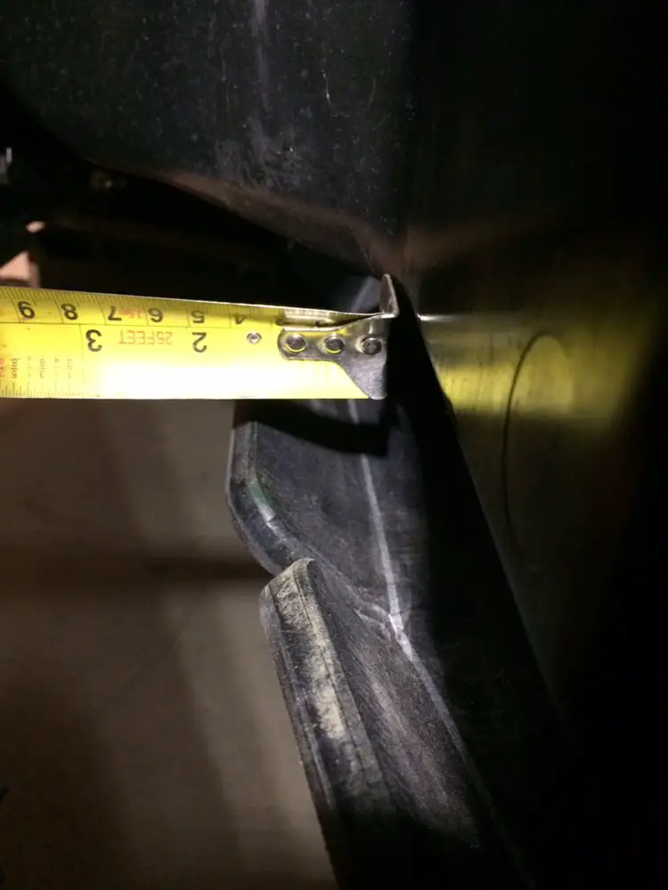

The L-bracket that came with had 2 holes in the wrong spot.
I added a 1/4 inch spacer where the L-bracket attaches to the frame to fix that.
Also I was missing the j-clip that one of bolts connects to, so I welded a nut onto the L-Bracket instead.
I'm a bit disappointed in a few of these details - for the amount of money I spent on a piece of plastic and a few bits of hardware, I expect everything to fit well. If the skid plate was 2 inches too short instead of too long then I'd be upset.
