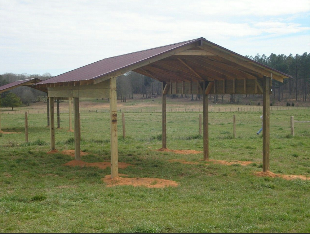

Your 4" x 4" x 10' posts are not going to be very useful if your idea is to build a simple pole barn. Your finished shed will have to be 8' tall to be practical. You'll need posts long enough to bury at least 4' in the ground to have any strength and stability. That would leave only about 6' above ground.
You may be a carpenter/handyman and know what you want but if not, my advice is spend a little time online searching for simple shed plans to get some ideas.

Sounds like enough to build a “lean to” off an existing garage or shed, is that what you’re referring to?
The frost line in Arkansas is 14”. 2’ is plenty for that and sufficient structurally for a small Pioneer shed…

Yeah, if it's only 14" I agree. I guess you're in the same soil and weather.
I would pour a bag of Sacrete around the base of each post to hold it secure. Arkansas is in tornado alley and high winds are possible.
