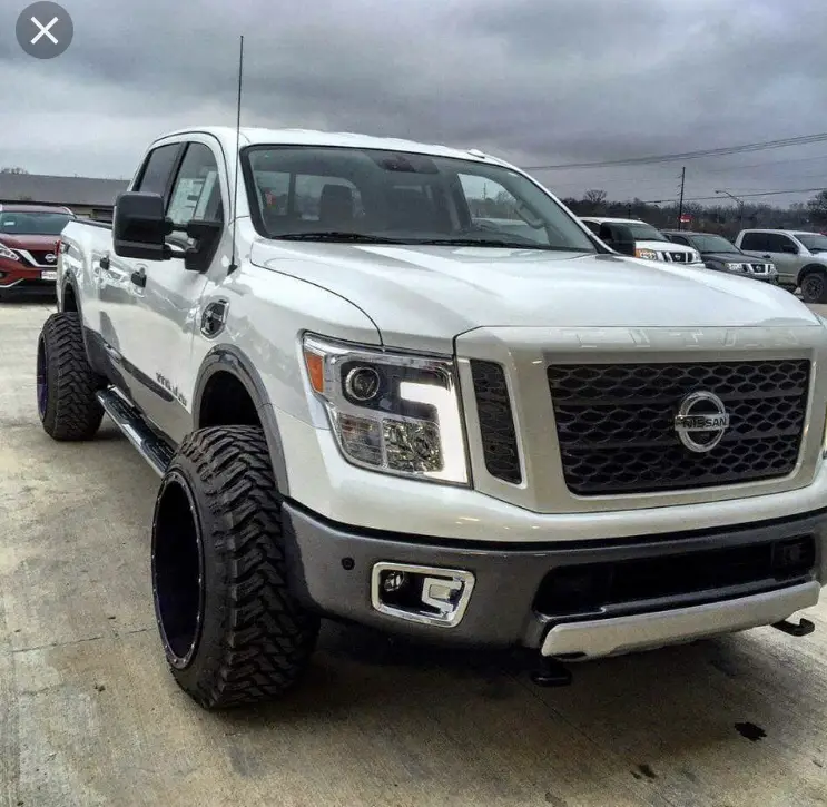

Hello everyone,
I have explored the deep bowls of the forum and haven't been able to find a clear answer. I am curious about running a 14X10, 0 offset wheels on all 4 corners with 30X10R14" carnivores. This will be on a rig that has a 2.5" lift and forward front control arms. I know we can run 14X7 wheels with 30" tires but unsure about running a 10" wide wheel up front. Anyone have any experience with this?
Thanks alot guys!

I'm running the 2.5in lift with 30x9.00r14 on all 4 corners. What is your concern turning full lock?

Why are you wanting a 10” wide wheel? Offset?

I have came across a dirt cheap set of 4 old/new stock MSA 14x10 wheels and like them over the factory wheels. I’m curious if it would clear all the steering linkages and control arms. I guess worse case I would have to add a spacer if something was to rub on the inside of the wheel.
Depending on offset... but I’m betting they don’t work very well on the pioneer.

Most people use a 7” wide wheel so I’m guessing those 10” wide wheels would cause some issues.
They would look like this....
