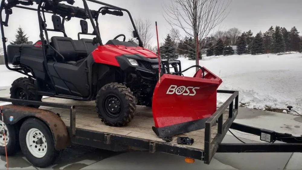

I bought the BOSS V plow, and love it. No turning back. Fc8442f659299e2bea056b2c185460a2

Nice boss system was not in my budget,glad your happy. I'm using my Denali plow without the power angle because they were on back order and I just haven't purchased it currently. I will purchase the power angle for next season for sure. Its a pia getting out and changing the angle often.
