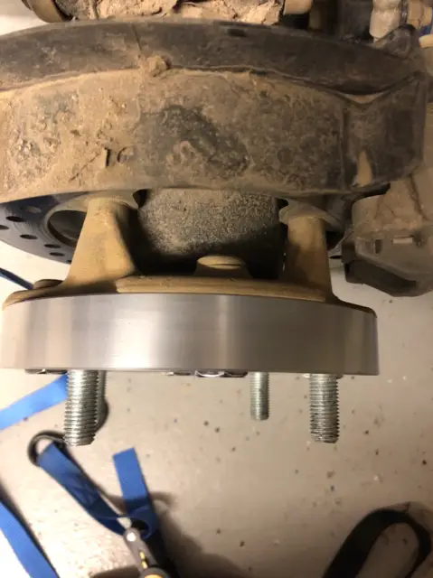

So I ordered some of your 1” spacers and I have a problem. The nuts stick out farther than the spacers do. This can’t be right. Can you send some new nuts? @RB3offroad

I went to there site, looks like all the nuts protrude farther than the spacers on all of there spacers, the wheels don't have recesses where these nuts protrude do they? I would go take off the rear wheel to look at the wheel but I'm going to ride around the countryside later. I've got two leakers, one front and one rear that I have to get repaired before I sell them (EFX Motohamers) and one rear trailer tire, tires!!!!!!!

I just checked mine and I have same issue - does not matter not as my wheel is not completely flat on back - but it will matter as my new ones will be flat on back.

This issue has been fixed for the nuts. They are shortened .100 so the sit below the threshold. The Stock wheels have clearance for these spacers. Sorry I didn't know all the wheels our there and how each one was made. We now have the lug nuts the right size! Thank you

@RB3offroad, Thanks for taking care of your customers. I got my new lugnuts installed and they fix my issues.
