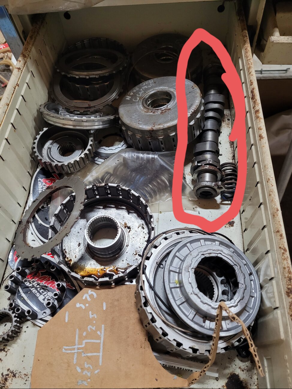

@snuffnwhisky has both evidence you speak of.

Just looked in a tool box drawer. Got some more complete clutches somewhere around here haha if anyone needs parts.

That fit in a Talon head? If so, want to sell it? I need a cam core to send in and be re-ground but can't chance taking mine out between races and not getting it back in time.
The thrust washer is thinner on the pioneer than talon. Probably need to start with a talon core. Have u talked to Web Camshafts? They can weld up and regrind.
Damn!
That's what I want to do but I don't want to take the cam out of my engine and send it out in between race dates. If I don't get it back in time due to a shipping mishap or other factors beyond my control I'm screwed for the following race.
$280 for a new one.
