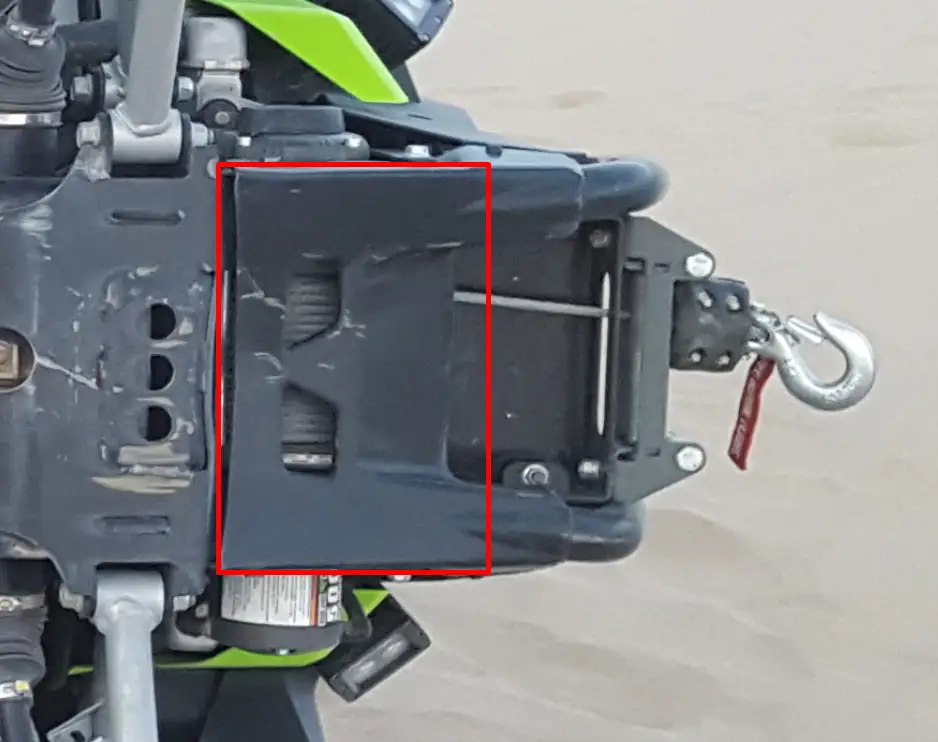

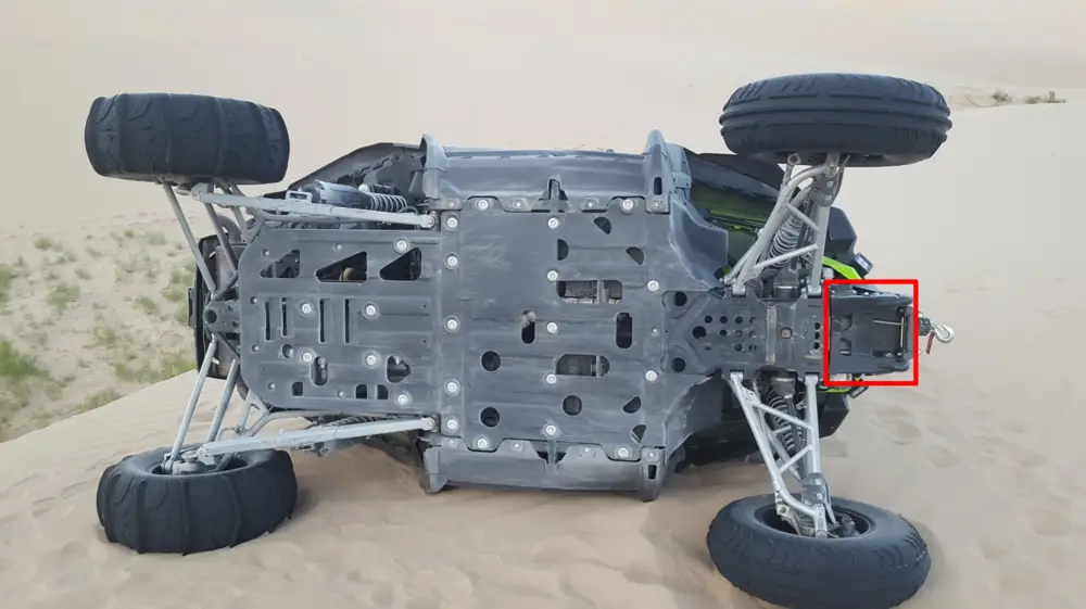

BTW, I looked at them all and the 2 main reason I went with the Factory UTV was...
  1. I have seen the other brands separate (become uneven) at that rear joint (where the stock one overlaps) and wanted to try to avoid that. The back seam on the FUTV skid not only overlaps (uses a kind of 1/2 dovetail style lap) it also has an extra plate that aligns with the frame and the rear piece bolts to and mitigates that seam from separating like others I have seen. So far, this seam remained perfect after some hard hits in Moab.
  2. I was constantly hitting the front bumper and bending in the lower plate. The front of the FUTF skid curves up the front bumper and protects that area and my winch. Probably only works with the stock bumper but that was OK with me.
Here you can see what I am talking about when I was doing my OEM skid plate inspection at the dunes before I got my new skids :) ...

And a closer look you can see the bent plate almost hitting my winch. The red box is the area where the FUTV skid extends and curves up and keeps that plate straight and protects the winch unlike the others...
