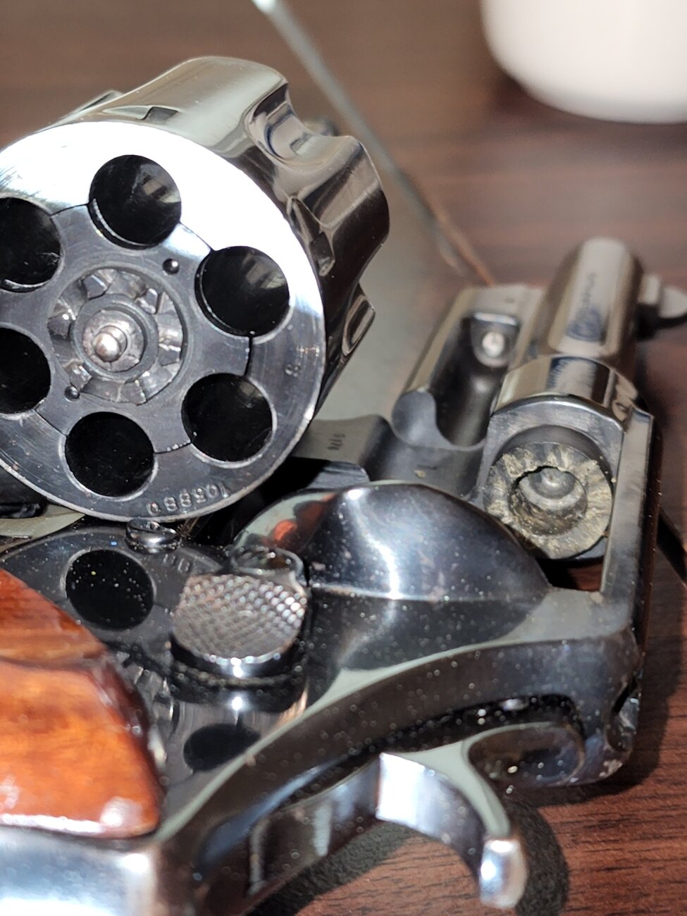

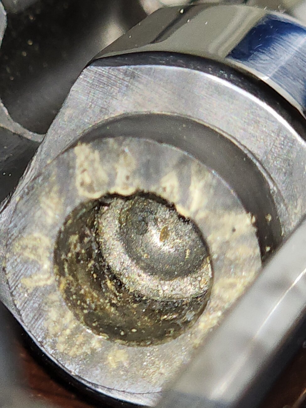

BAD...BAD...BAD!!! RARE! RARE! RARE! ::::::::SQUIB LOAD!::::: Why you pay attention to recoil and SOUND ! Potential for Serious injury or Death to you and anyone near!!! If you try to fire another shot Barrel Rupture or worse is LIKELY! If you hear funky, light sound or just noticeably different Sound ,,,STOP FIRING,,,, Point firearm in safe direction wait to insure no misfire or possible late fire. Clear firearm if possible. If you are unsure, keep pointed in safe direction and notify knowledgeable person. This happened to me today, .38 special S&W .38/44 Heavy Duty 20220322 201634 resized20220322 201707 resized

BAD...BAD...BAD!!! RARE! RARE! RARE! ::::::::SQUIB LOAD!::::: Why you pay attention to recoil and SOUND ! Potential for Serious injury or Death to you and anyone near!!! If you try to fire another shot Barrel Rupture or worse is LIKELY! If you hear funky, light sound or just noticeably different Sound ,,,STOP FIRING,,,, Point firearm in safe direction wait to insure no misfire or possible late fire. Clear firearm if possible. If you are unsure, keep pointed in safe direction and notify knowledgeable person. This happened to me today, .38 special S&W .38/44 Heavy DutyView attachment 325902View attachment 325903
