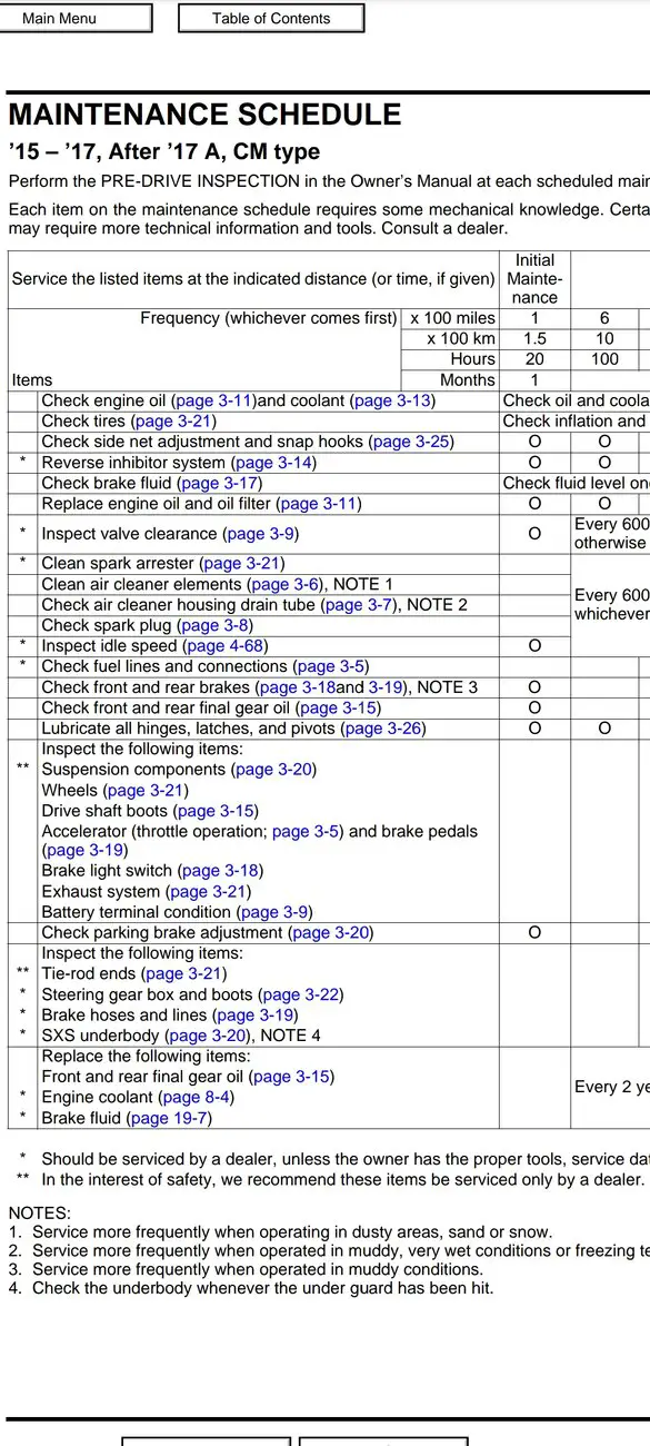

I'm not gonna stoop to those levels and call you any names but sit down old man and let me learn you something.
Im not like some people on here who talk out of their ass about stuff they know nothing about. I've been repairing Honda products for 16 years and know my way around quite a few of them.
If youll take a look at the maintenance schedule for your machine ive provided below, its clearly shows that a valve clearance inspection/adjustment is due at the first 20 HRS or 100 MILES. So your machine was due for a valve clearance inspection/adjustment at that time.
Screenshot 20241107 152413 Drive
So the next time you think your right and I'm wrong, maybe shut your f***ing mouth before you come at me for being incorrect.
Have a nice day!!
Have a nice day!!
LOL! "I'm not going to stoop to call you any names"... but then you end it with "shut your f***ing mouth". Much better. At least I was kidding. Everyone knows walruses have great breath, so it was a compliment. Jeeez don't blow a gasket. Thanks for the correction. I misread the manual. You are right. I am wrong. Thanks. Still, seems like a very early point of use to be checking valves.
