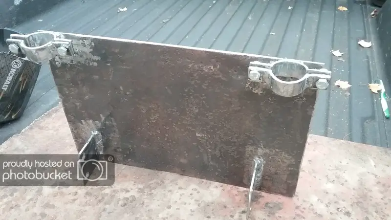

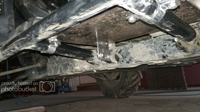

Well a car size battery won't fit where the stock battery goes, so a mount had to be made to accommodate a larger battery, then once you have the battery mounted longer wires will be needed. I made my own mount ( I'd post pics but photo bucket is holding them captive) from 3/16 steel plate and went to my locally owned auto parts store for some custom made wires to get me where I wanted to go. Really the hardest part was the mount.

Here’s a picture of the battery mount I Purchased from a company that is no longer in business.
02ebbb41b0f3c6a3c9d6ee261c4f9fc8
You can see the heat shield in the picture. That is probably important for the life of the battery to reduce some of the heat from the exhaust pipe
