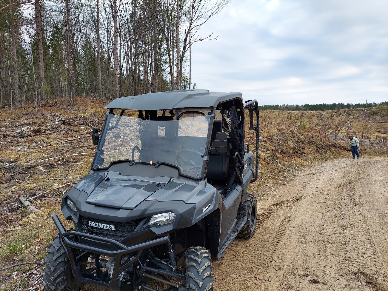

Start at post #6 If u figure it out dont be like Epstine and leave us hangin!
We also need pics of your rig. There isnt any of it yet. POIDH
20210427 162338
