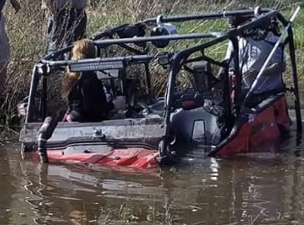

This is a problem I have as well, it is like sitting on a block of ice! Eventually, on mine, the heat from the engine slightly softens it, but I can see how purchasing a new one could be a good idea! Not sure how the water got into mine:oops:
9477D246 95F1 43CF BAC2 A5746686578F
Wonder if those seat covers could help meo_O
