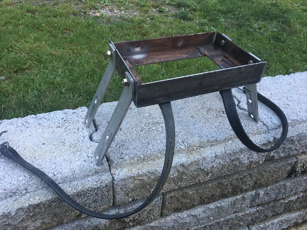

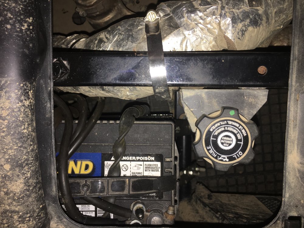

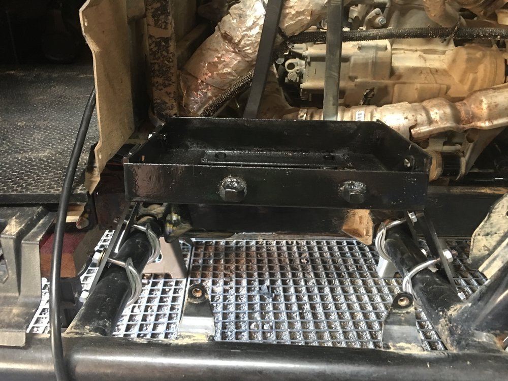

Yes a lot of us do it.I have a car battery and the stock battery with Isolator.My headlights and starter run off stock and all my accessories run off car battery.
