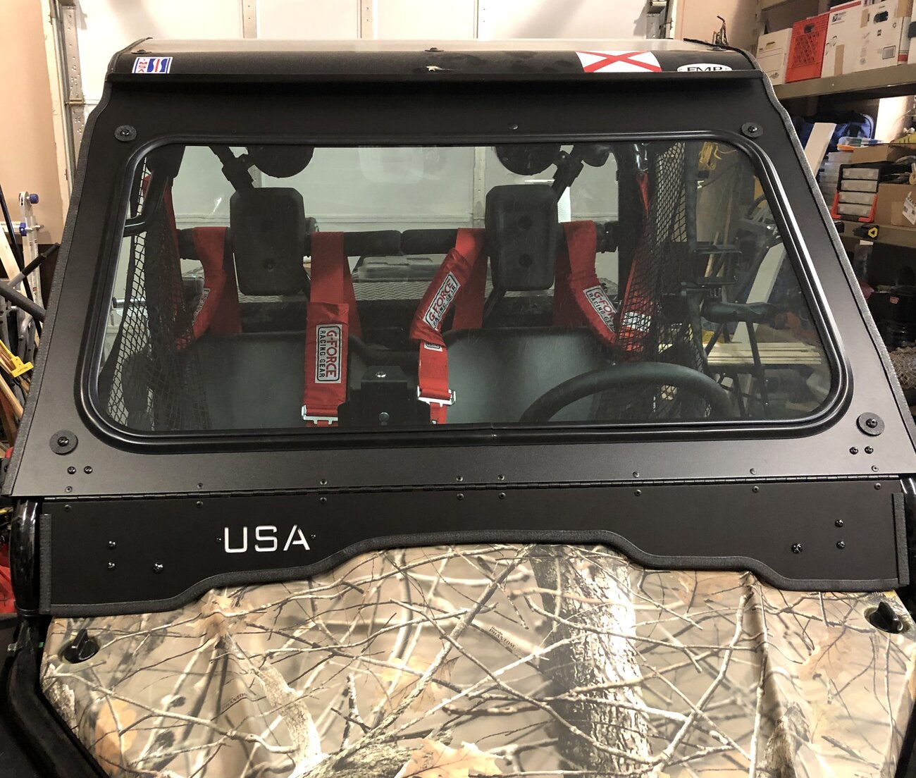

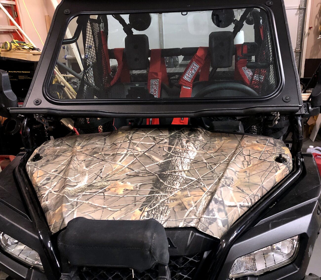

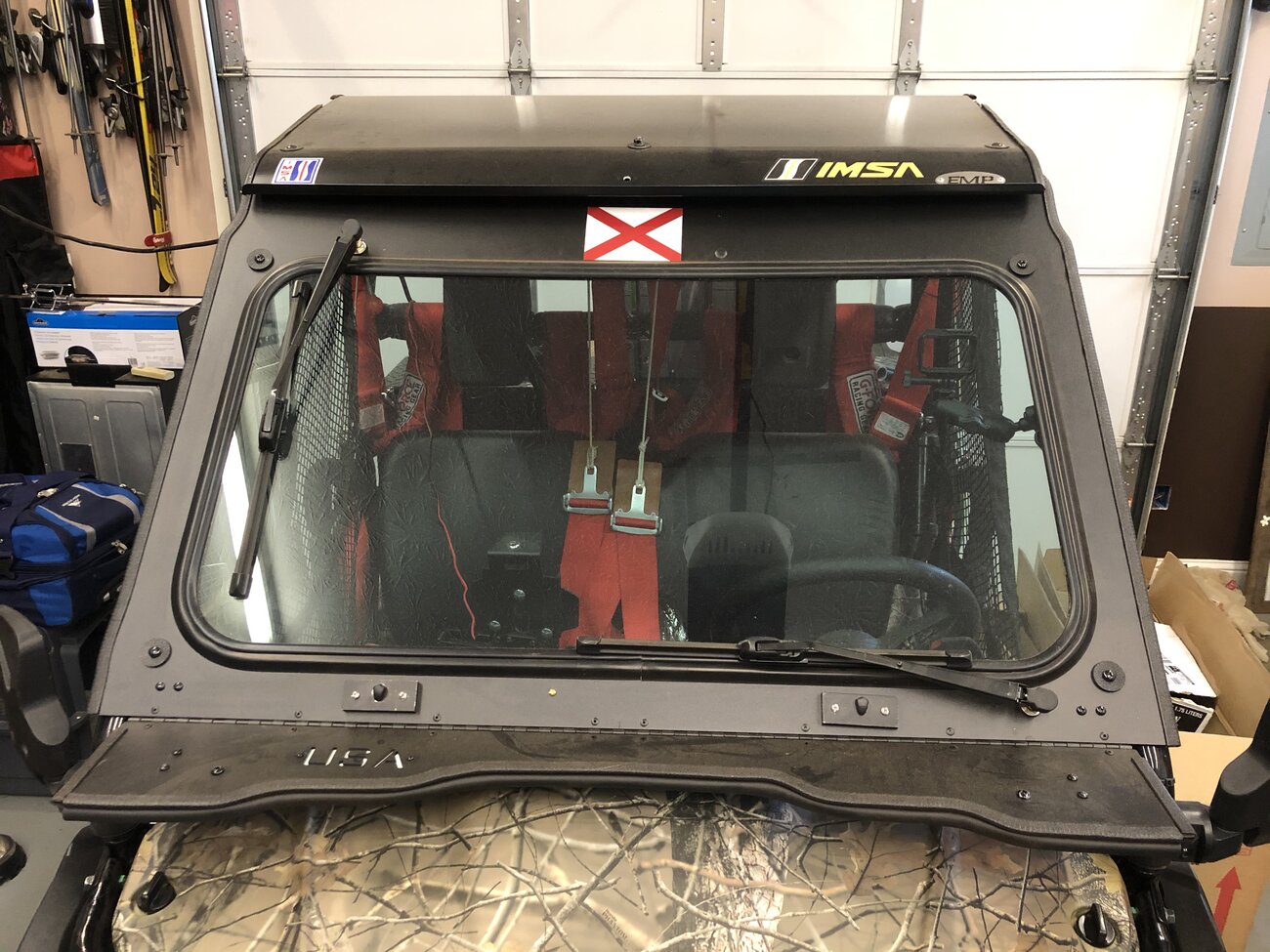

I have the sXswindshield (UTV windshield) which I like very much. Bottom is hinged for ventilation as well as front hood access. I have also added a windshield washer pump and reservoir along with wipers. If you get frost on a glass windshield you can scrape it just like on your car. If you don't go with glass, be sure to get hard coated plastic, my first windshield was not and within 18 months you could barely see through it.
Trigger shield should be on you list of add-ons regardless of windshield choice.
Sxswindshield08
Vent closed
Sxswindshield11
Vent open (before wipers)
Windshield Wiper Out
Vent open with wipers and washer nozzles

Which roof are you using with that utv windshield? How’s the fit with the windshield on?

I have the EMP (Extreme Metal Products) aluminum roof, there is a small gap at top of windshield. Photos are on my laptop which I don’t have with me. I’ll be home tomorrow 31st and will attach photos and give you measurements of the gap.

Sxswindshield07a
Left side windshield to EMP roof - there is virtually no gap at the top of windshield and roof - possibly 1/8 to 3/16" maximum.
SXswindshield19a
Right side - notice the EMP roof overhangs windshield - what looks like a gap is actually the top of windshield to front side clamp of EMP roof, this is on the side not the front.
SXswindshield17a
Inside view of windshield molding and roof

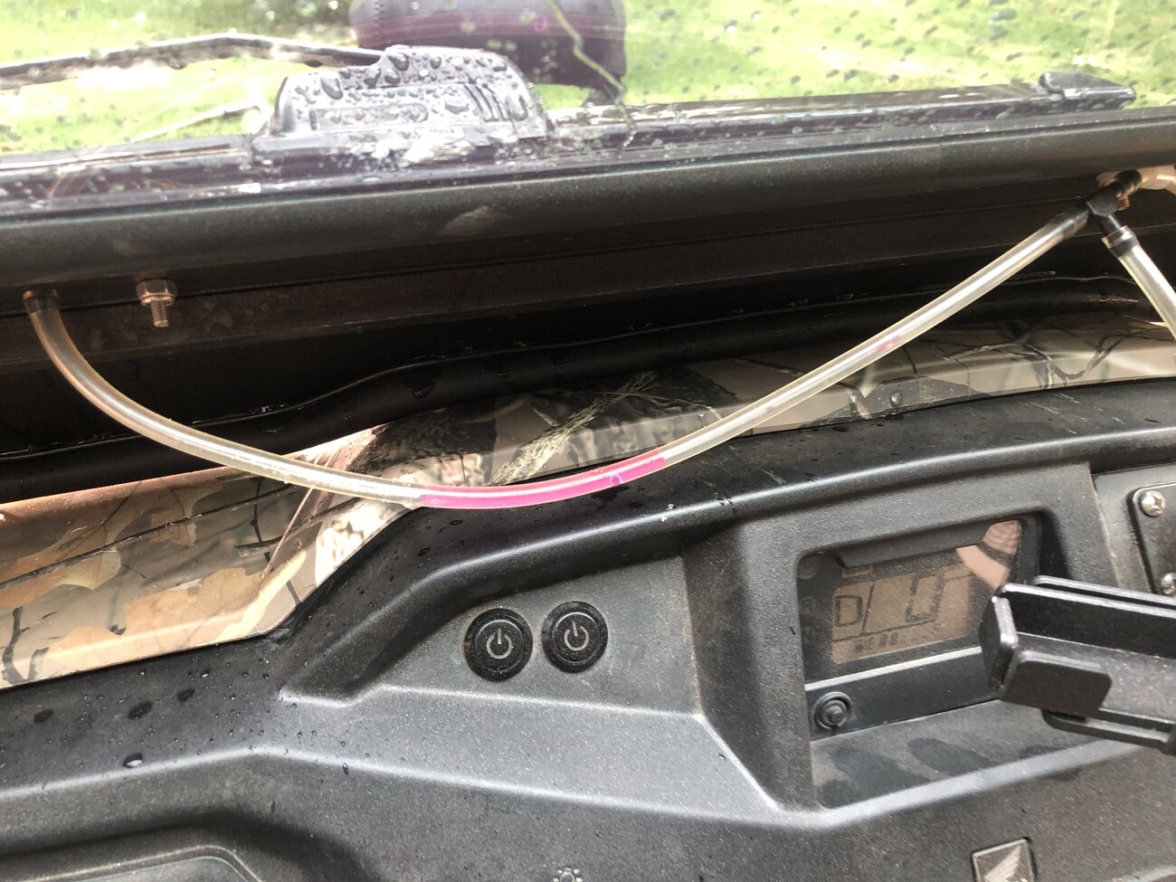

What did you use for a wiper and washer kit? Allot of kits available with dubious quality, and I want to get something that works the first time around. Thanks!
Wipers were from Kemimoto via Amazon
https://www.amazon.com/gp/product/B079L4J8YV/?tag=sxsweb24-20
Only draw back is due to pre bent arms, passenger side is mounted at the top, see pic in post #4
Washer pump and reservoir came from Advanced Auto Parts, unfortunately I can't seem to locate additional info on that, nut as I remember it all came in a kit (see photo for reservoir). To mount reservoir I took a piece of aluminum flat stock, bent a 90 and fastened to cross piece.
If I get tired of hand cranking wiper, I'll change out for a 12VDC Marine wiper package.

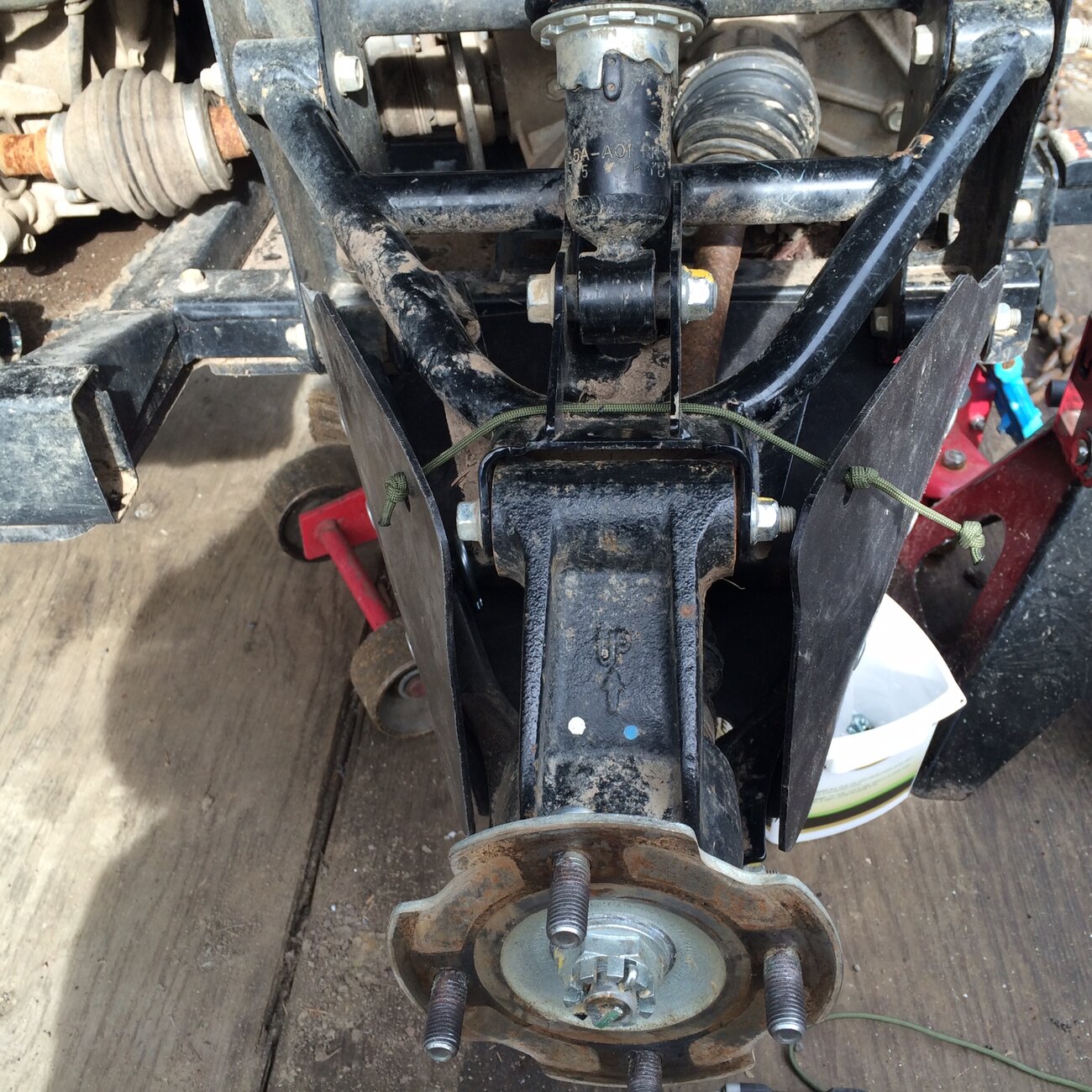

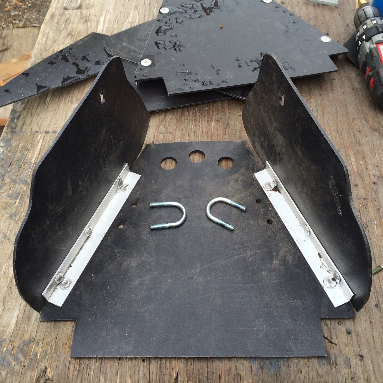

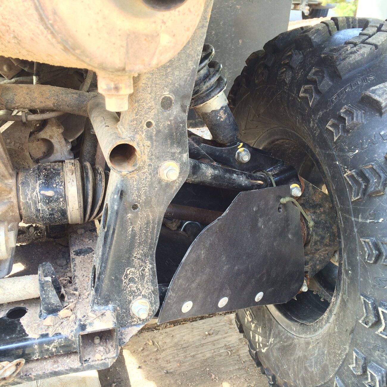

JCart very nice! I've been tossing around the idea of building my own too. What thickness aluminum did you use? It looks like you built your own A Arm Guards out of UHMW?
JCart
JCart
Jul 14, 2014
895
2,021
Kamloops, BC Canada.
I don’t remember off hand, will try and get thickness for you tomorrow. Yes the A arm guards front and rear are UHMW and aluminum angle, U bolted to X brace on A arm. As I bought the Dozer in fall of 2014, at the time there were limited options or aftermarket was prohibitively expensive or on back order. So I’ve just made stuff instead, it’s kinda fun and you get pretty much what you want. Apologies for the derail Fellas, if it’s a concern please delete.
Cheers
R stx stopper R stx stopper 2 R stx stopper 3

That's awesome thanks for sharing! I'm also in the house of building myself too. As you know north of the boarder here things tend to be quite expensive so we have to do what we can with what we have. Great work.

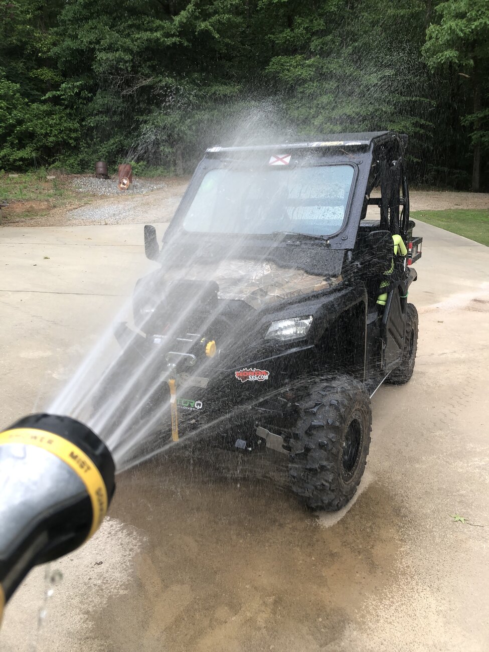

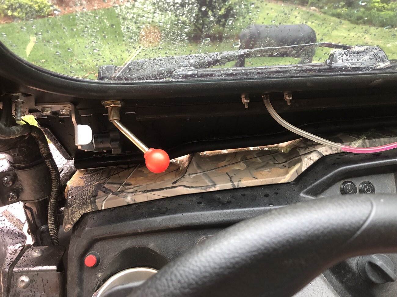

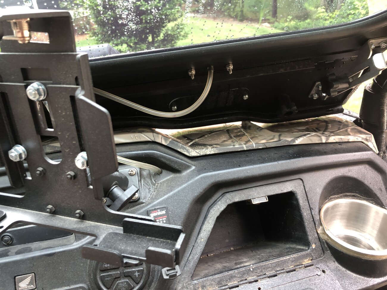

Sorry it took a while to get back to you, somehow I missed your question. Here is a link with a couple of pictures from inside on page 3 post #45. I can send you more pics when I get back home. So far i haven’t noticed leaks at hinge, but I’ll do a hose test and let you know. P500 - Honda 500 Full Glass Windshield
As I mentioned, running in the rain I haven't noticed leaks, but then again I was driving and not looking for drips.
Did the hose test, spraying on windshield for about 1 minute and very little water from leaks inside cab.
Hope this helps.
UTV WS 2UTV WS 3UTV WS 4UTV WS 5
