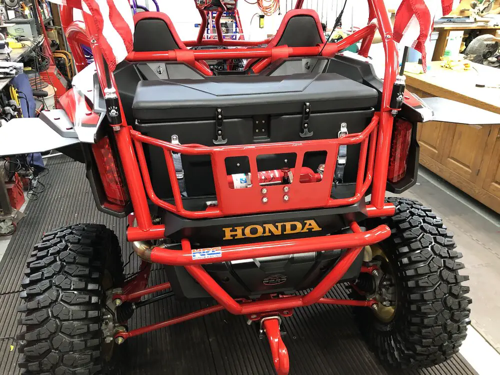

That's exactly what I did on mine Jason. I used some left over spacers from a roll bar light mount that I'm not using any longer. Worked perfectly on my 1 3/4" cage and HMF rear.

That's exactly what I did on mine Jason. I used some left over spacers from a roll bar light mount that I'm not using any longer. Worked perfectly on my 1 3/4" cage and HMF rear. View attachment 210791
Yes sir - I remembered either reading that or discussing it with you previously so I'm "borrowing" that idea for my own use :cool:. I've found myself on a few occasions now needing a rear hitch point for recoveries and decided to make the switch to make life a bit easier when those situations present themselves.
