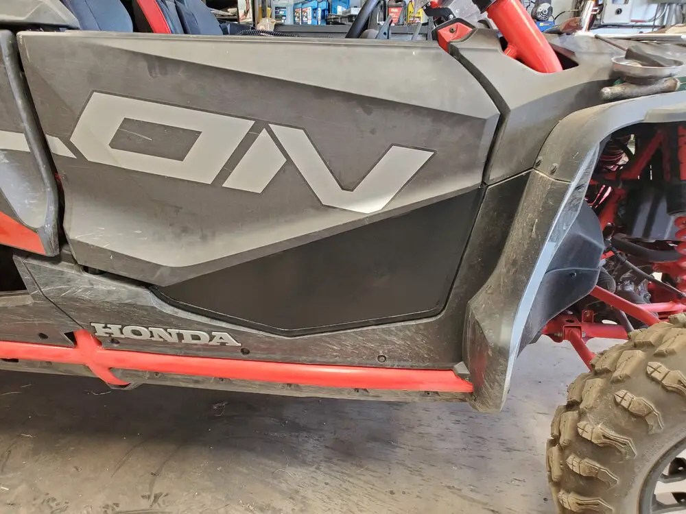

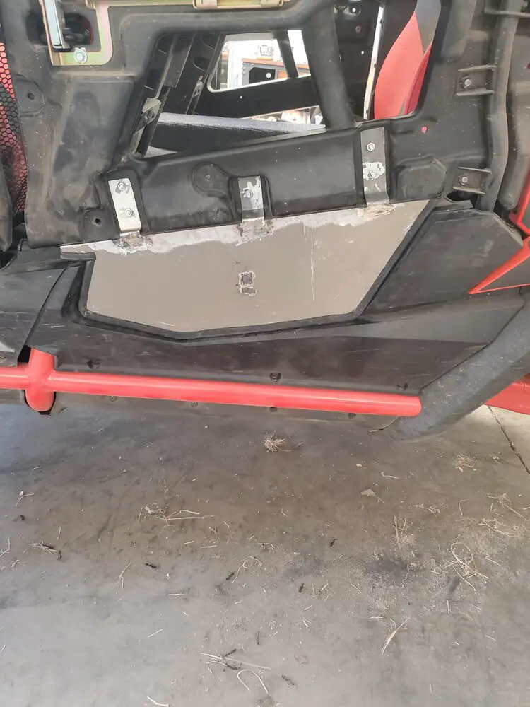

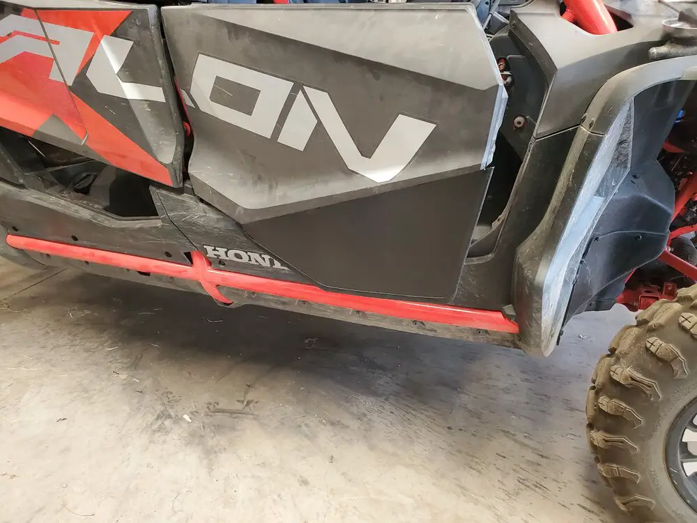

Hey,
After buying my Talon and using it for the first time last, I, like made a list of what was needed. Lower doors was on that list. But, after looking at the prices, I decided to make my own.
I used the sides from an old washer/dryer combo. I made cardboard templates first, then cut out the panel. I cut the brackets from the same material and bent to fit. I welded the brackets to the panel. Painted with 3 coats, then put 3 coats of Rhino liner on them. Put a rubber u channel on the lower side. I spent about $30, instead of $400.
I glued the u channel prior to painting and putting the Rhino liner on. I wanted to make sure there was a descent seal with the panel and the channel
I drilled and attached where the dimples are on the inner door.

Hey,

How sturdy is the panel with the 3 brackets? If you accidentally kick the panel out some, can you easily bend it back in?
