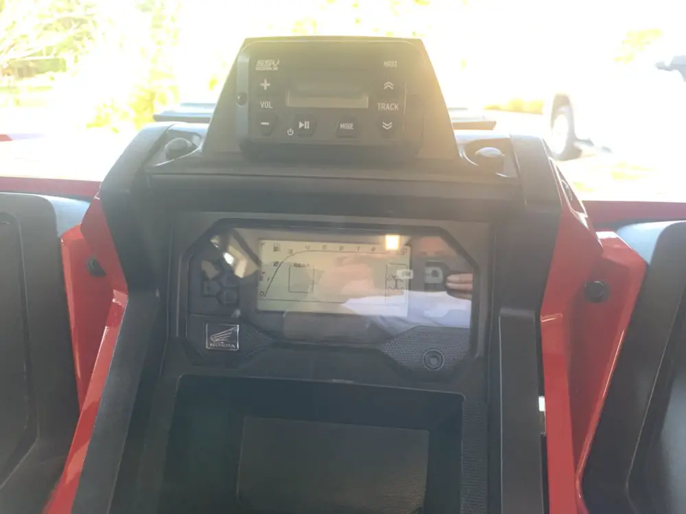

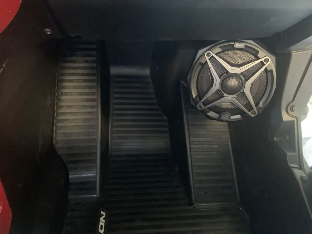

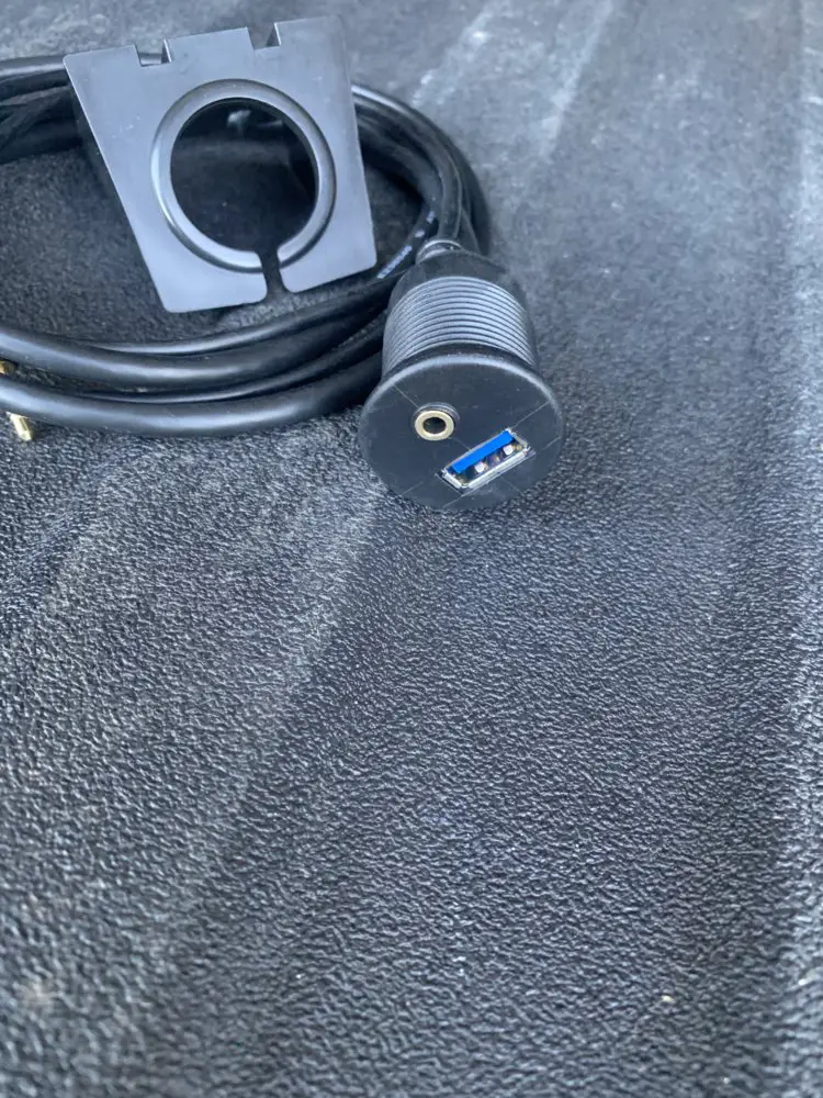

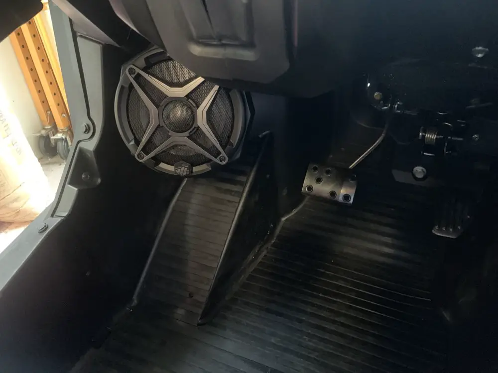

It sounds good but not super loud. It has a 4 channel amp so you can always add rear speakers. I just wanted a little music when trail riding and it is great for that. I tried some rear hanging speakers but I did not like the noise right by my ears. The fit and finish is pure Honda and it is nice that it all just plugs in. I ordered a different input for the glove box. The one that comes with it only has a mini audio plug for sound input. I got one on amazon that has a USB charge and a mini audio input. The amp already has a USB charge plug to attach too. Here are a few pics. It will also work with the Honda factory full and half windshield. I guess my other decision is I was able to get it for $550 on eBay. That is cheaper than most aftermarket sound bars.

I replaced the SSV with kicker marine speakers and that helped. Still wasn’t as good sounding as I wanted to I added two more speakers. Huge difference with two more speakers. Fits really well, just have to trim the side floorboard behind the speaker.

Where did the get the dash extension above your speedometer
35,445
208,728
Go to the vendor forms and you will find Speeder or something like that that uses a 3D printer to make them.
