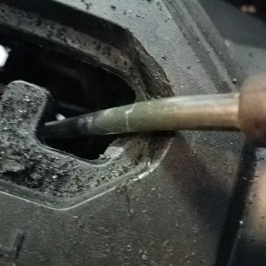

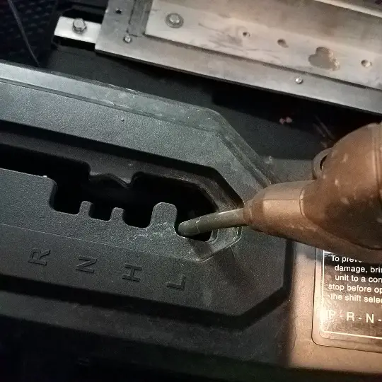

Pass this info along to other Talon and Pioneer 1000 owners.
How to prevent the Loud Bang. It may occur more often when the engine is cold. This can occur on the Pioneer 1000 too. See page # 33 in the Talon owners manual.
Make sure the sub trans is fully into gear before applying the throttle. The display must show your in gear with a R, H, or L.
If the dash “ – “ is on the display your not in gear.
If you apply throttle it will go into gear but with a loud bang and sub trans gear damage can occur. You can feel the shift lever is loaded forward with the shift cable holding it to the end of the shift notch when its not in gear.
For Reverse and High you can over shift a bit if necessary especially when the engine is cold. Taking your foot off the brake can help. If it rolls a couple of inches that will help it to go into gear too.
When I shift mine into Low range or reverse when cold sometimes I get the dash “ – “ on the display. If I roll it an inch or two it goes into gear. I can feel the shifter is loaded forward in the low range or reverse notch and not fully into gear. It can be the same in high range too.
I modified my low range shift plate so I can over shift a bit like I can in Reverse and High.
My Talon has done this a few times in 6,000 miles and my 2016 Pioneer 1000 has done it a couple of times in 19,000 miles. It occurs mostly when the engine is cold. I use low range to load it on my trailer. After driving for about 20 minutes it goes into low range ok.
Shifting into reverse can also have this issue especially when the engine is cold but you can over shift slightly in high and reverse and it will go into gear.
The shift cable is adjusted to center in the neutral position which had the narrow gate.

The CA shift gate is easy to knock it out of gear and shifting back and force you must be back to idle before shifting. When your in Low the lever should move back and forth slightly, same with High and Reverse. When your in Neutral it should be half way between Reverse and High. You can lay the stock shift plate next to the CA shift plate to check for neutral. I'm at 7,446 miles now and have a problem shifting into Low some times before driving it for about 15 minutes. I'm using 0w40 Maxima full synethic motorcycle oil now. It seems to fix it most of the time. If it doesn't want to go into low I move it forward in high about 2 inches then it goes into low. With the stock shift plate when its fully into gear you can wiggle the shift lever back and forth in the shift gate a bit. If its loaded forward its not in gear and you will have the "---" on the display. When you shift into park the shift cable is pulling the sub trans shift lever. When you pull back to shift into gear the cable is pushing the sub trans shift lever and its not as positive. I modified my shift plate so I can over shift into low a bit.
