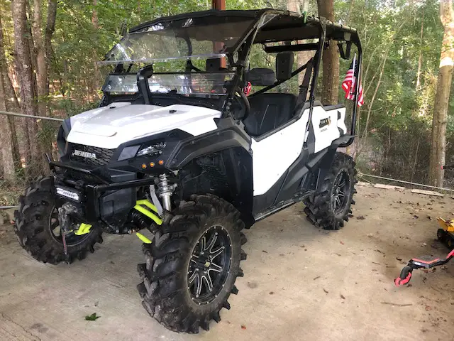

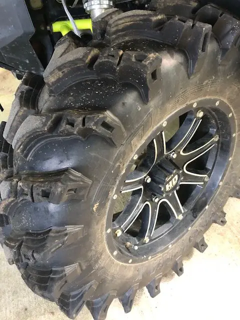

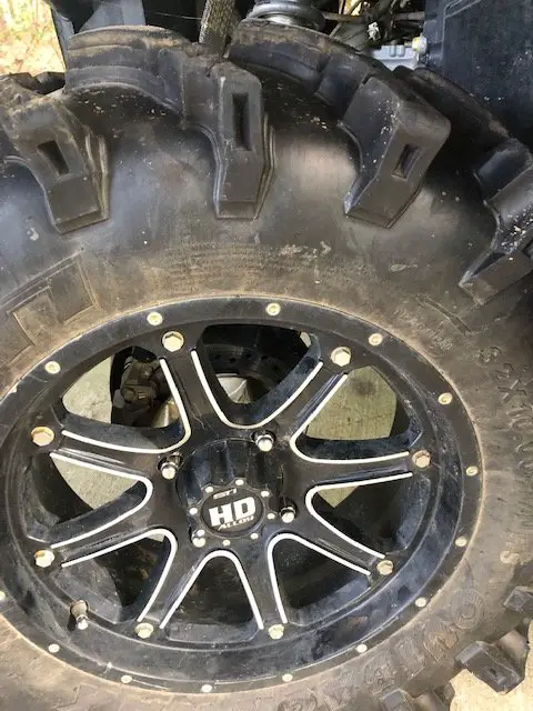

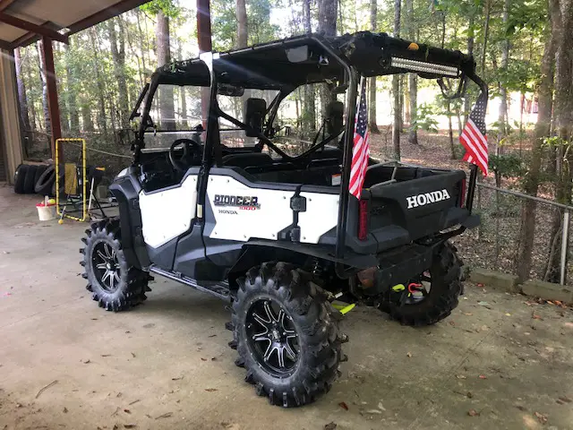

The key to running a 32" or even a 30" on a pioneer 1000 is to keep them light. Use low! Last set was a set of 30" zillas. Now I'm running a 31.5" otani r-1 "4-ply". Last set of rim were 14's these are now 16's. Now I know you all may say 4-ply wth? but they are almost as light as a 30" and if I puncture they are like 85$ a tire. They are a tiny bit heavier, and I haven't had to diff lock 4 low to truly test them. I do like the setup though. They ride good and pull great. A pioneer 1000 with around a 31 is a bad mofo.
