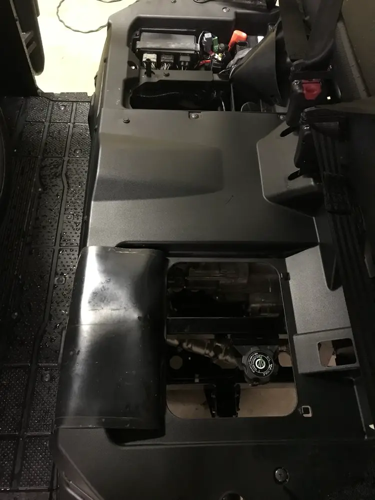

After looking over my 700 I’m thinking of installing my aux battery under the seat next to the main battery and also putting the solenoid and isolator there as well. I would like to put my aux fuse box and relays under the drivers side of the seat. My question is, is there a certain length the wires should be to each other for optimum usage. Like wires from battery to relays to fuse box ect. I think it’s like 16 inches from where my aux battery will be and where the relays and aux fuse panel will be.
What size battery are you going to use for auxiliary battery.and how are you going to put it beside stock battery?
And the fuses and relays will have to be in a marine style fuse and relay holder under the seat. It's hot and damp under there and sometimes when you hit water there is steam. I recommend you run a 8 gauge wire or larger from The auxiliary battery up to under dash or hood to relays and fuse box. And wire out to accessorys that way.

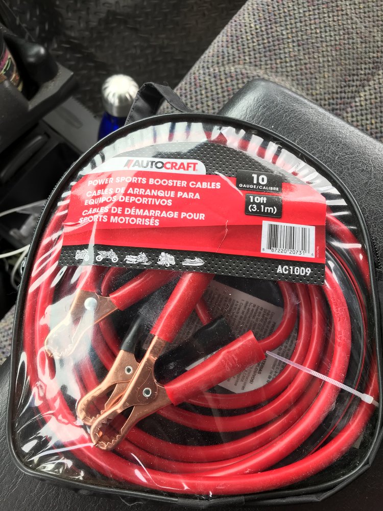

So I picked this up today at advanced auto, was looking to buy 8ga wire by the foot to run from aux battery to under the hood for my fuse panel ect. They didn’t have 8ga, This says 10ga but is heavier then the 10 ga I saw in a small roll and this was cheaper. I will just cut off the clamp ends will this work?
NOOOOOOO
10 is way too light for battery cable, 6ga or larger at a minimum, I bought some 2ga jumper cables from amazon fairly cheap.
