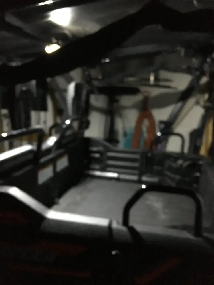

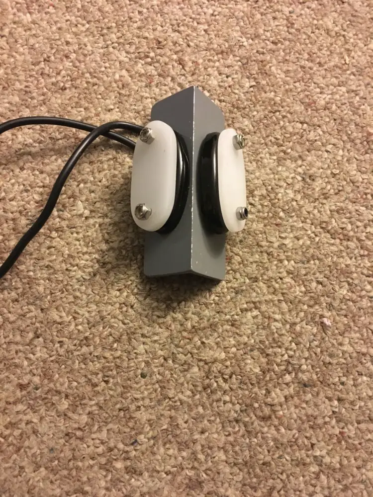

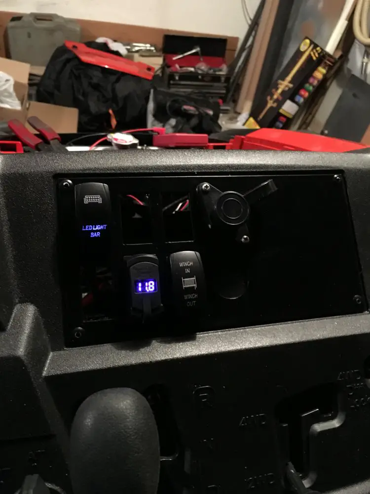

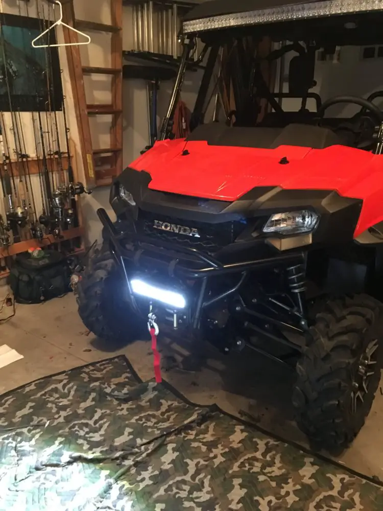

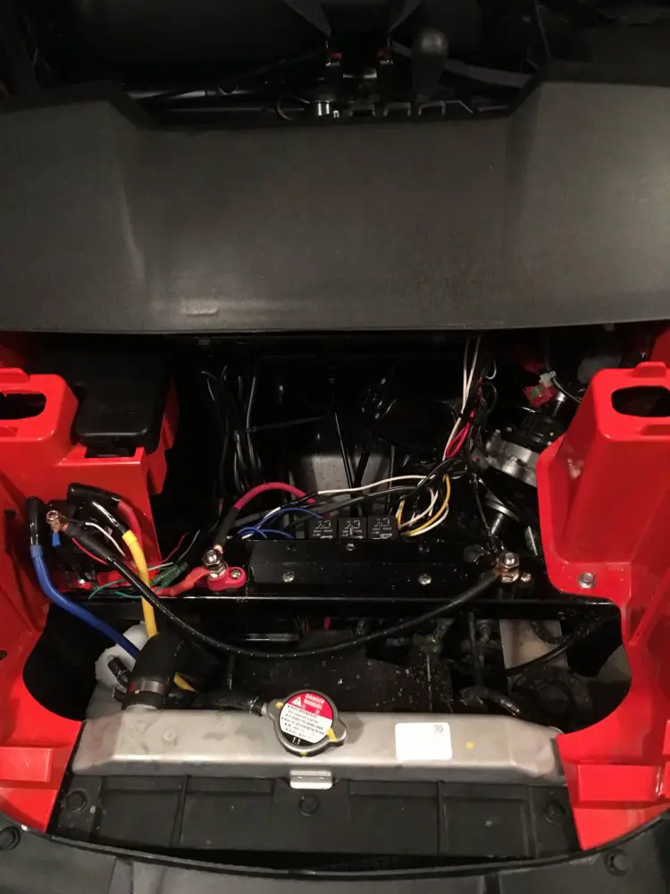

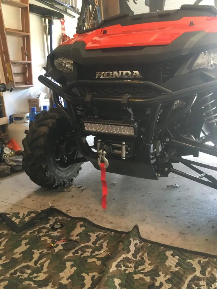

With help from a friend, we started all the wiring yesterday to hook up my 5000lb winch, and all the lighting I’m adding. The factory headlights are all but useless, so I added a curved roof light bar right after I picked up my 700-4D.

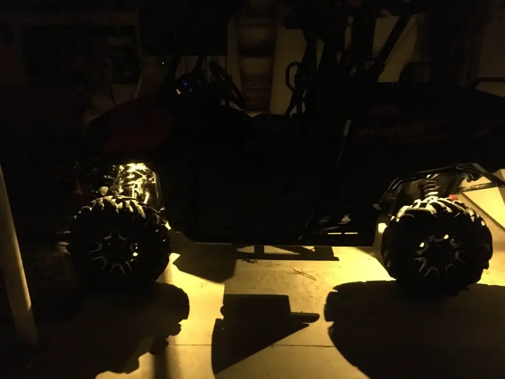

We got the winch up and running, ran remote battery posts to under the hood, got the reverse lights hooked up. We mounted my bumper light bar (fills that hole above the winch perfectly), interior lights (I used 2 rock lights mounted to aluminum angle with opaque plexi diffusers), rock lights, and new switch panel. Tomorrow we are planning to complete all the wiring. Very anxious to get it all done!

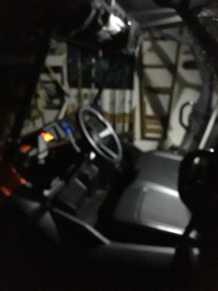

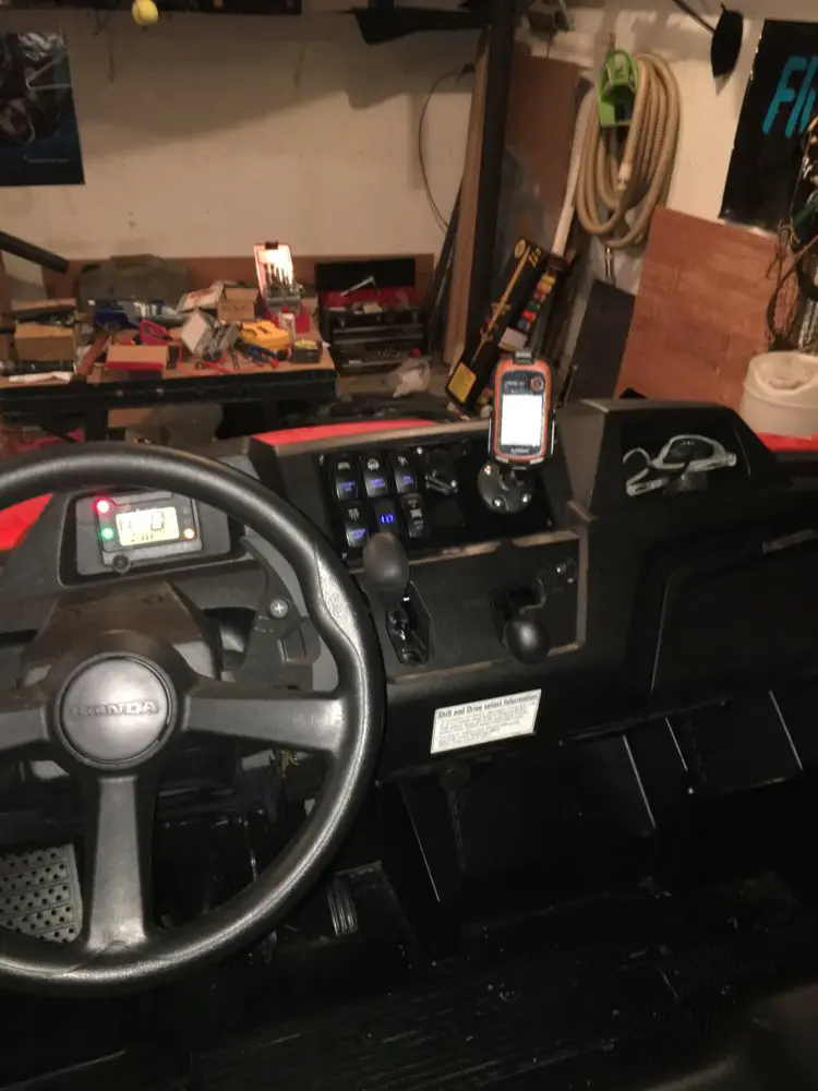

Got it all wrapped up tonight. Probably 30 hours in it all. Everything works great! We did have an issue where we (uh...I) blew a fuse without knowing it. No dash, no lights, no winch. Nothing. We finally realized it was the 10a fuse, after I remembered seeing it in a thread on here. I’m happy with everything, especially the interior lights! I never had those in my Rhino, but often wished I had them. Otherwise, the trail will be well lit in front of and behind me! With the engine running, and all the lights on, I’m still at 14 volts.

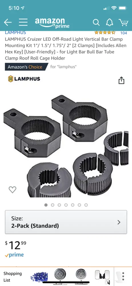

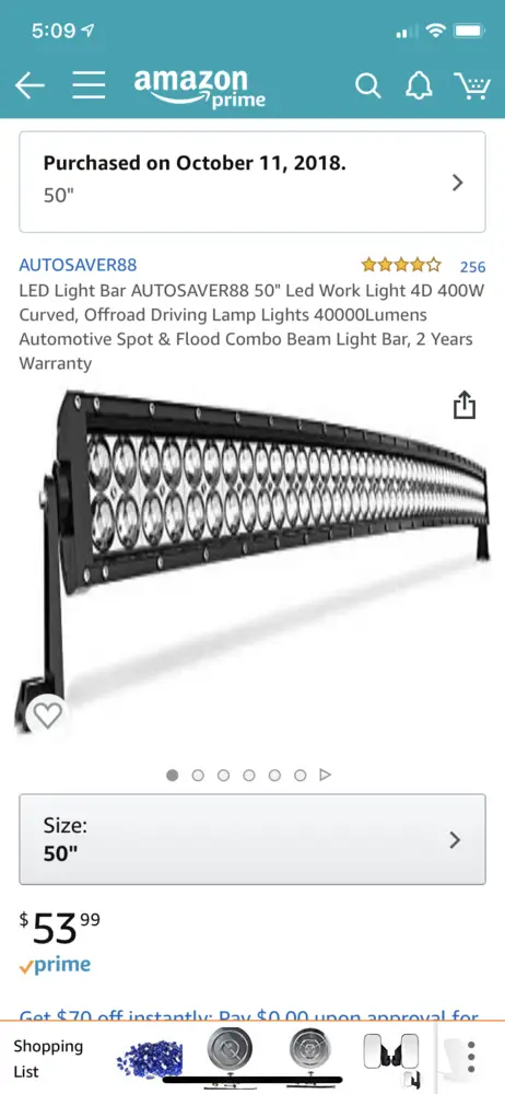

What size light bar is that up top? Curious as to jow you mounted it. I just purchased a 52” for my p-700 and looking for ideas. I want to mount it up just under the roof.

Just curious where did you get the dash switch box?

Looks Great! I am currently doing a similar project, just not as many lights at the moment. I do really like the interior lights!! Are you happy with the front led light bar? I want to do the same set up. Can you please send the info on the led light bar and mounts that you choose?
