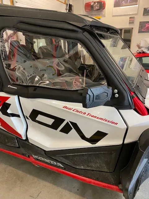

I don't think there's anyway a mirror that mounts to the roll cage will work with the Honda upper doors. I mounted the mirrors to the door itself.
Did you make your own brackets? How long have you had them on and still solid?
One could bolt directly to the roll cage between the windshield and door, I suppose.

The "bracket" is just a flat piece of metal welded onto the inner door frame with two holes drilled into it to mount the mirror. The mirrors are Tusk Pivot folding mirrors that are meant to mount with the two bolts on the roll cage. I had them mounted to the roll cage before I got the upper doors, but I couldn't see a way to make them work mounted to the cage. Also, even if you could mount them to the cage with the upper doors installed, they may not be in the proper position to see out of them, especially the passenger side. They've been on for about three months and are still solid. I thought they might vibrate some while driving, but they really haven't.

This is as low as I could mount the Seizmik mirrors with the factory bracket.

Well, I finally got a driver's side mirror to work, by mounting it below the 2 heavy duty cage bolts. Passenger side is mounted there but it's too low to see from the driver position. They're the Side Mirror Package from doubletake (Components | Doubletake Mirror).
