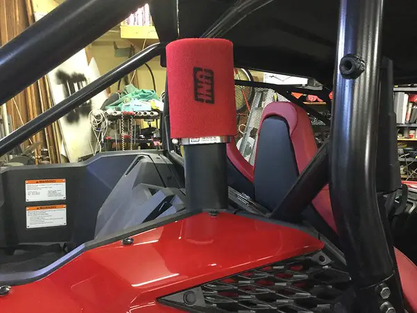

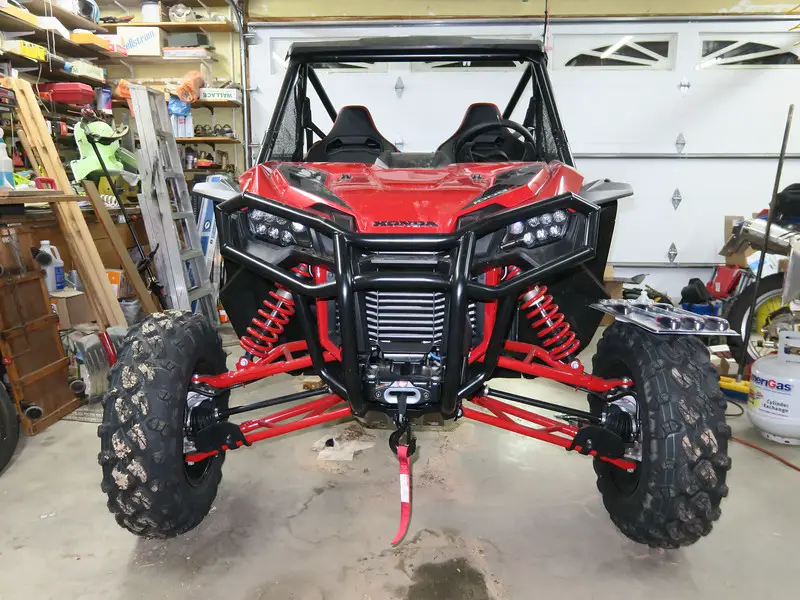

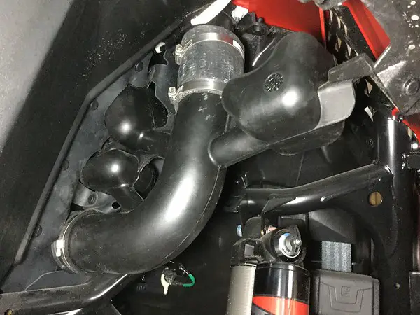

I've added the 1/2" Trail Armor skid assembly, copied @hondabob 's snorkel idea (details in his Talon 6,000 and 10,000 mile ride reports) and in the process of installing the Ryco turn signal/horn/license plate light (lots of 'stuff' to do but taking it 'one bite at a time'). I also have the TA trailing arm protection yet to install and haven't decided on the A-arm protection because I don't know which high clearance arms I might end up with.
The reason I went with Bob's snorkel is because he keeps the goofy air intake chamber 'thingie' - I think it's a noise cancelling measure and don't want to listen to the HONK of an unsilenced intake all day. I didn't run it up to the roof because that brings the possible noise even closer to my ears. With this, I can extend the filter straight up, getting the noise exit higher and even more above my ears if necessary.

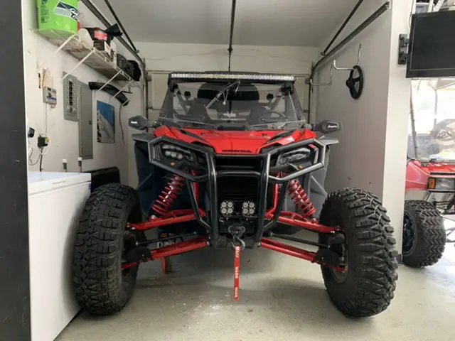

in the PNW the trails are tight with lots of trees that have branches sticking into the trails. it is especially bad after a snow or in the spring. I use the steel Honda bumper and it offers a lot of protection around the front fenders and headlights if you are going to be mowing over cactus and varmints.
