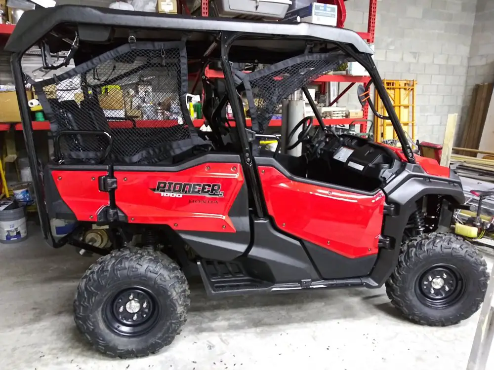

If its a big price difference its the way to go. I saved about $2,200 going with a bsae over a DLX, I put panels and some lights, waiting to wear out stock rubber to upgrade. $ well saved.
20191115 221357
20191115 225343
42,062
322,675
