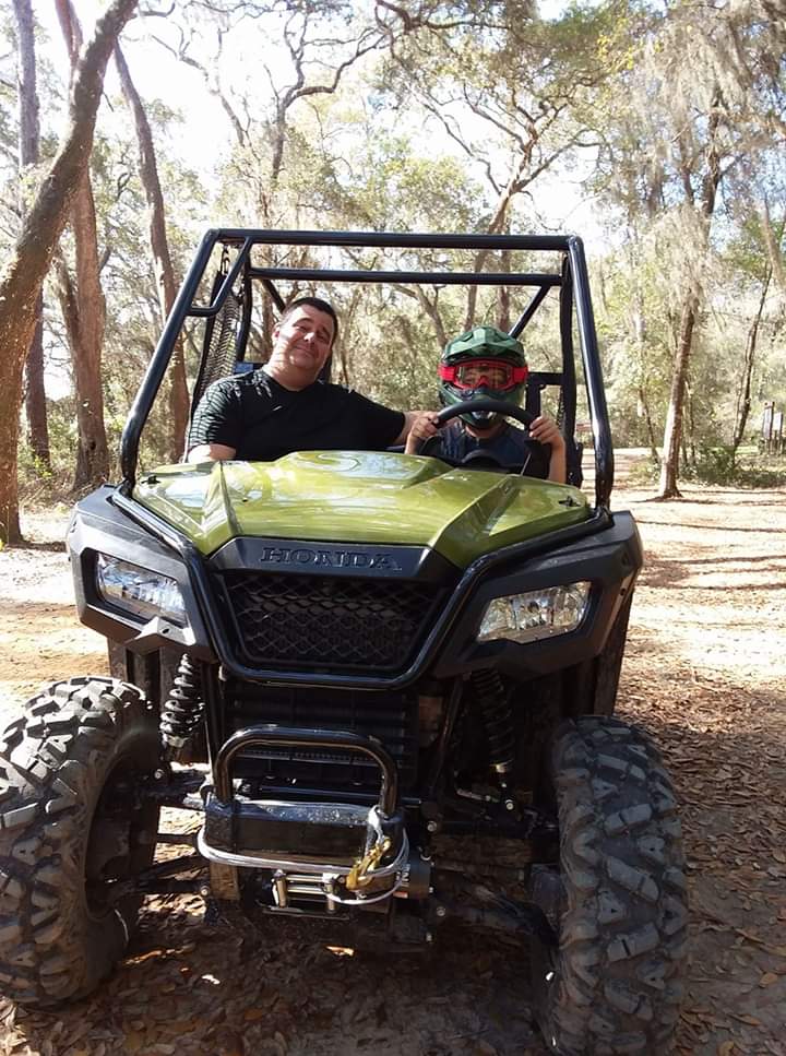

The diff's may run a little cooler changing to synthetic gear oil.
What would you guys recommend being I live in Florida run the hell out of my P5 in sugar Sands I would like to quiet them down and keep them cool

Mobil 1 75W/140 seems to be popular here. I'm going to put it in mine when it warms up. (Not because it's too cold to run, but the barn isn't heated and lying on the floor stinks)
Although my differentials aren't as noisy as when I got the machine. Quieted down around 1600 miles.
