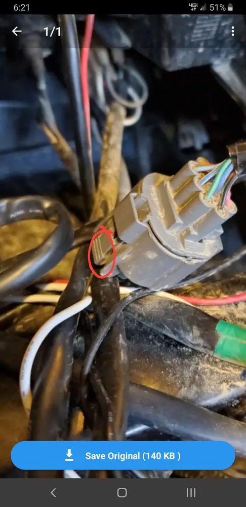

Squirt it with a little wd40 or something. Let sit a few.
Then push here and wiggle apart.
Make sure there is no mud stopping the clip from rising when pushed.
