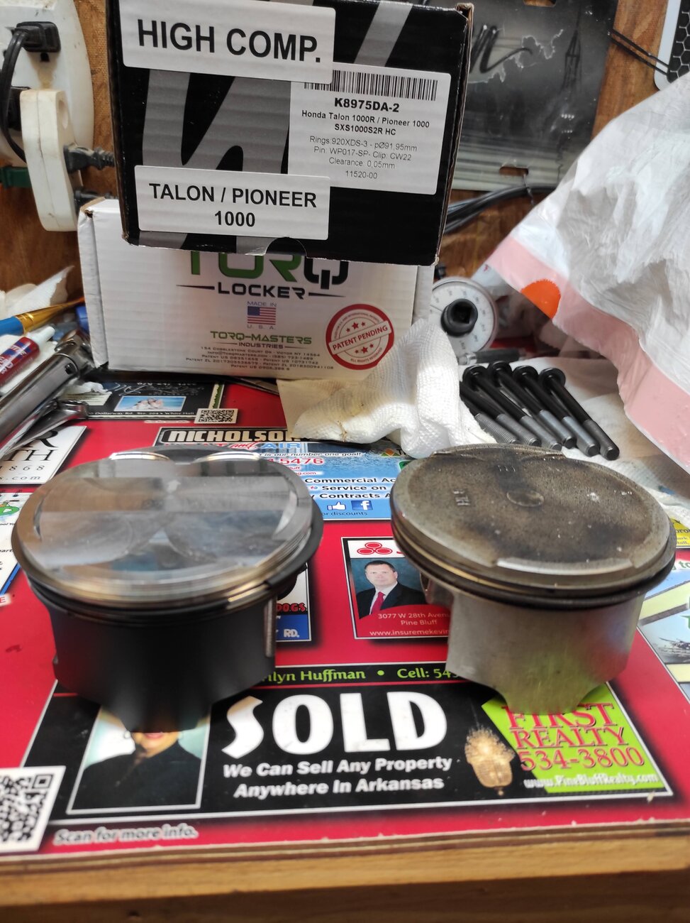

I was wondering what all they had done to the Talon in the video because it appears that they didn't do anything to the the head & they said nothing about what camshaft they were running, but I would have to think that this was more involved than just doing a piston swap, return fuel line & map sensor upgrade to get those numbers, I'd be curious to know what kinda boost numbers they are running as well? But I think the book is being extremely generous with 26 hours to R&R the engine on a Talon, it's not difficult at all after you get past the seemingly hundreds of push pins holding the interior panels in place because they can be fun after they are full of dirt and stuck, I ended up just going the easy way and drilled them out and replacing them with new ones that are soaked with WD40 and saved. myself all the time trying to get those push pins out. But I had to replace the crankshaft so I had no choice on removing the engine but it was a lot easier to build sitting on the bench than trying to do it still in the car. I had Hess do my head and cam but this was in October last year and I didn't know that Brian Crowler had stuff for the Talon or I would have rather went with their camshaft for sure just because they offer a new camshaft with more lift and duration instead of having a stock camshaft reground like I had mine done.

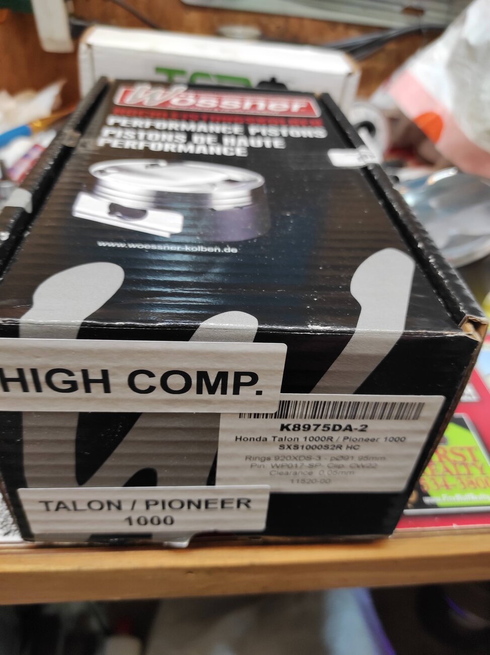

I have a pair of those Wossner pistons that I didn't use if anybody is intrested, Id cut someone here a good deal on the kit. They are advertised as 12-1 compression but are closer to 11-1 so I went with custom Crowers instead. They are really nice pistons and the machining is second to none. If they were true 12-1's they would be in my motor.
