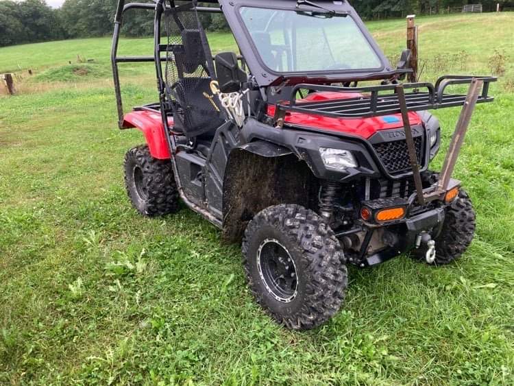

Thanks for the idea! Used a roll to make a set of 3“ rear inner fender extensions and a set of full front fender and inner wheel well shields for my P500. You can see the layer of cow “poop” built up on the inner fenders.

Now that you have it you'll find many uses.
Original reason for purchase:
Needed to fill space Above & Below Rear Hard Panel ( with Slide Open window ) making at the time for 2022 P520
Pictures of rear panel.
Thanks for the idea! Used a roll to make a set of 3“ rear inner fender extensions and a set of full front fender and inner wheel well shields for my P500. You can see the layer of cow “poop” built up on the inner fenders. View attachment 353508
Have since :: coverd the under side of P520 dump box >< keep snow & mud out ( space between box & outer panel )
I have some 1/8" plastic purchased years ago, when I added 1" spacers. Never installed though. Now running with rims that added about another 1" +- so, need to add the front fender flares. I'd be interested in how you mounted yours. I'm thinking a couple of muffler clamps on the frame tubing, along with the plastic plugs.
Sorry right in the middle of wrapping up the last of haying for the season, once things slow down I will do a decent post or video. I cut the plastic and heated it so it covered the usual mud flap portion and also folded over and covered all the holes twords the radiator under hood area. It came out nice.
