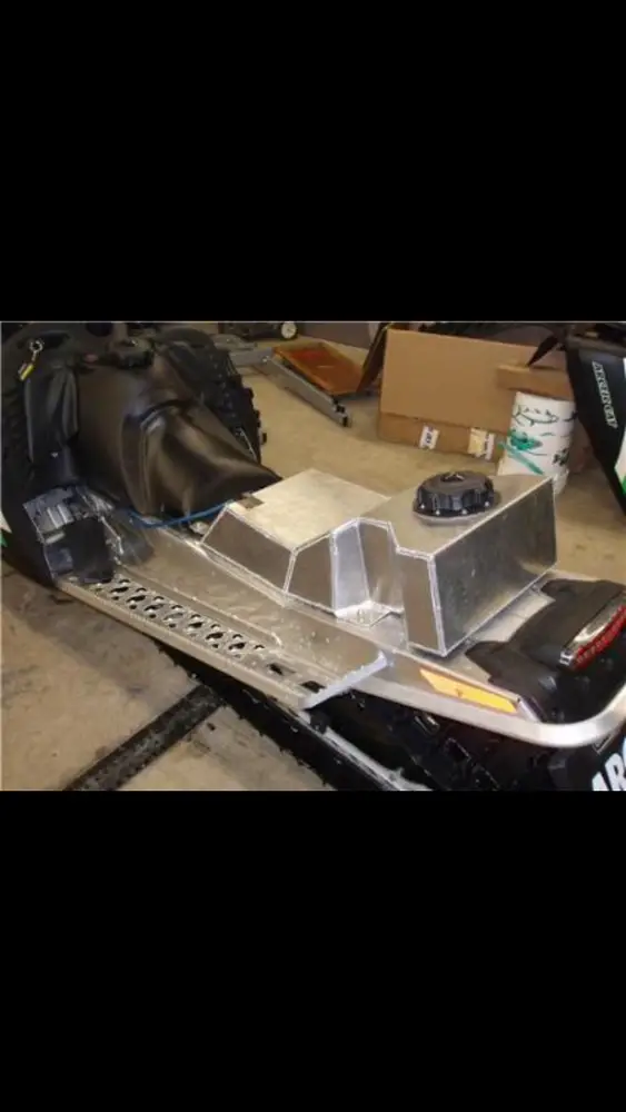

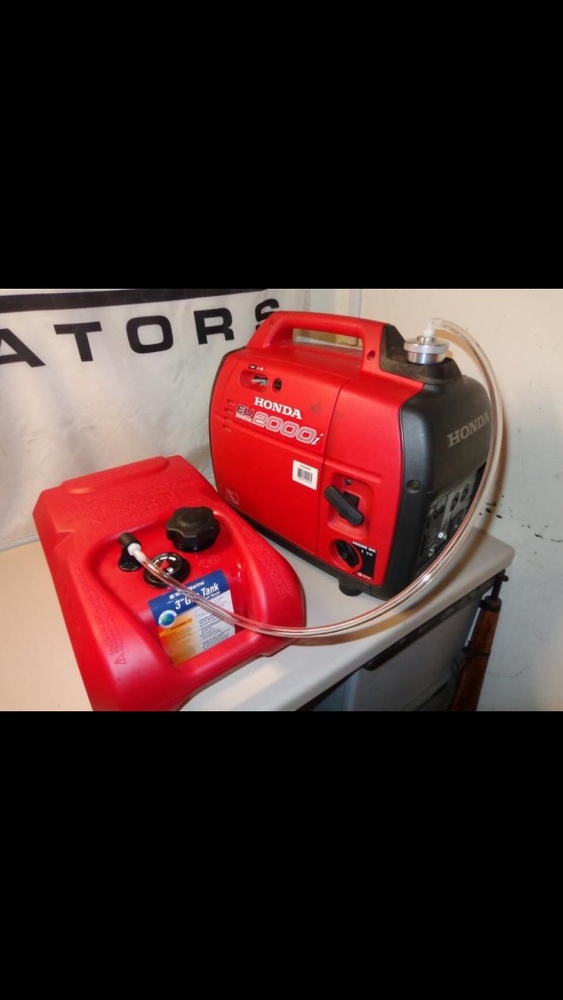

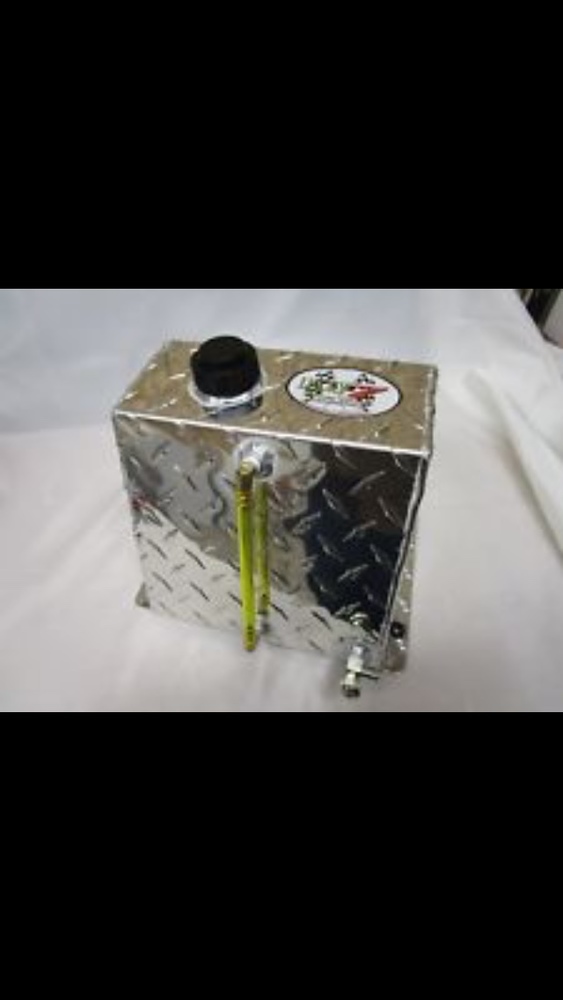

Not sure how the p-500 system works but I know lots of people who have aux tanks on the back of there snowmobile. They have aluminum tanks made to whatever size you want with a 1/4 nipple welded to the bottom and another on top as a vent.
They extend there vent line from regular tank to the nipple on the bottom of you aux tank and it will suck simply by vacuum. No pumps needed.
Almost all the riders of Cain’s quest (longest snowmobile race in the world) have this setup.
The aux tank will empty first and reg tank stays full until aux is empty. No switching tanks/pumps... very easy to do.
Lots of people with Honda generators do this also. 1/4 nipple screwed into there cap and fuel line extending off nipple and into a bigger tank. This is not gravity flow, all vacuum.
I’ve thought about this setup, either with a 6 gallon boat tank or get an aluminum tank made up to put on rack.
Watch some YouTube videos on how this works... very very simple.

Interesting...…...so it looks like the biggest problem is finding the right size tank to fit the space we have under there.
Newfiebullet
Newfiebullet
Apr 13, 2016
82
187
Labrador, Canada
Easiest thing to do is have one made. Any size/shape you want. My brother in law just had a triangle shaped 55 gallon tank built for his jet boat. Fits right in the front of the boat.He had an extra nipple welded to bottom and top where he ran a clear gas line so he knows how much gas he has. I will have something rigged up, maybe 6-10 gallons when I get a chance and get my rack set up like I want it.
