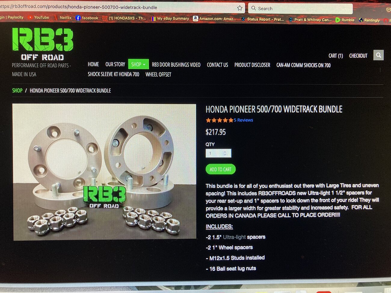

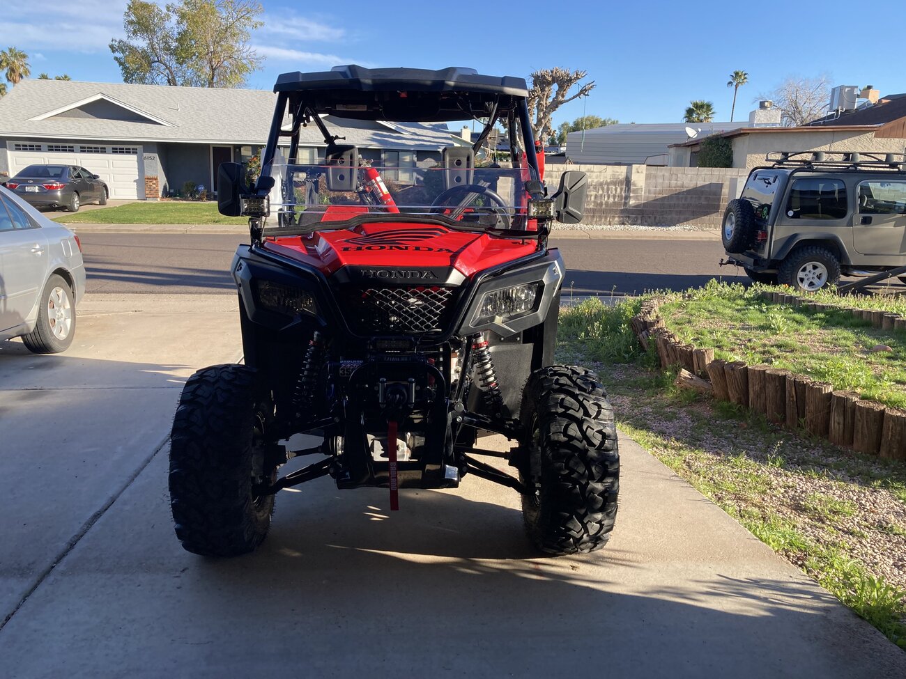

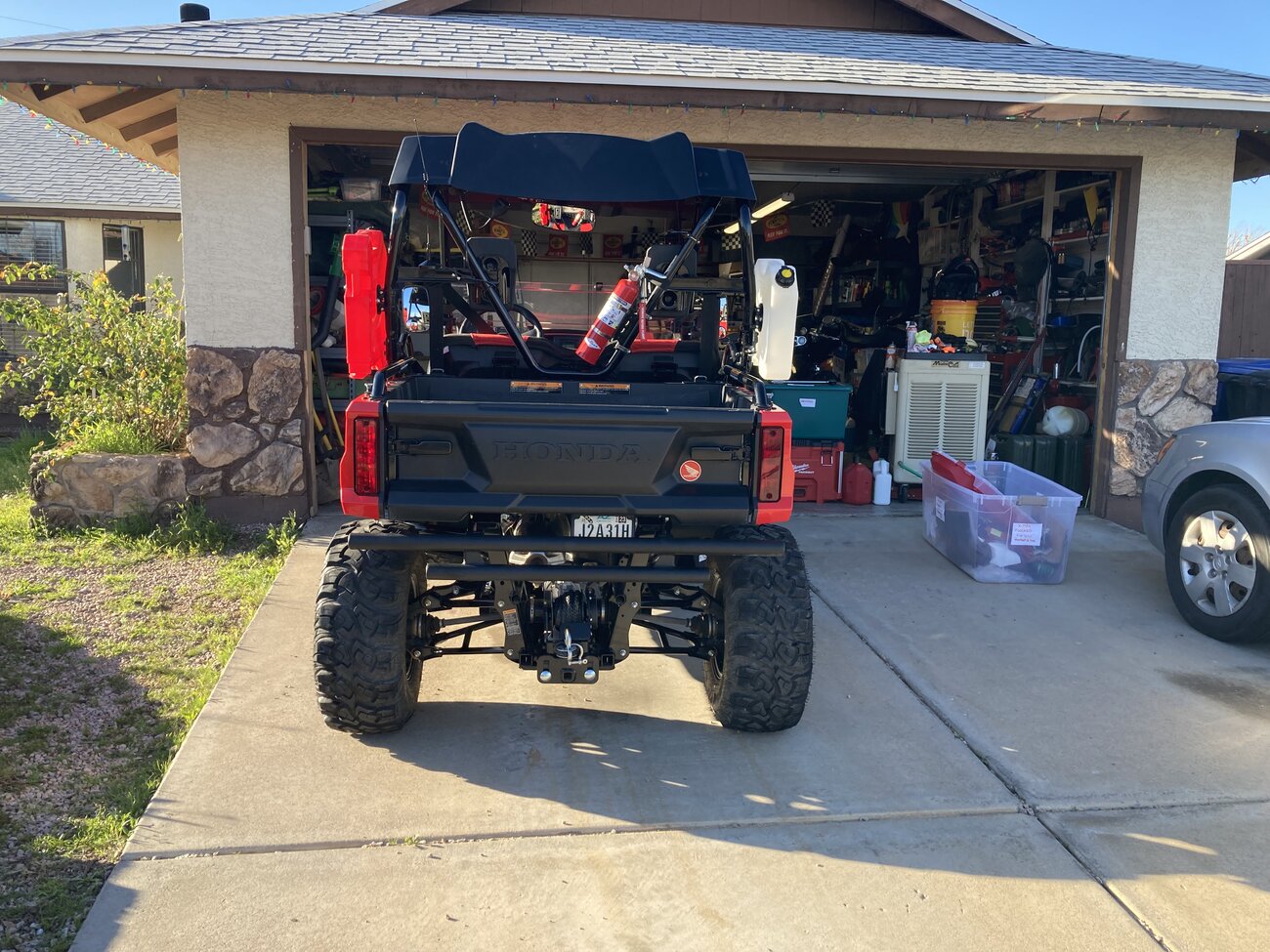

Just got the RB3 Spacers installed. There a local shop and build Quality products to boot. I got the Wide-track Bundle. 1" fronts and 1.5" rears with attachment hardware. They now put the 520 at 57" front track and 58" rear. I left the Elkas at the current preload to see how it works. They are set +1 thread on the front and +2 threads on the rear from Elkas original settings. Tires at 9lbs front and 11 lbs rear. With the recent rains and washed out trails I'll take all the extra track I can get. Wifey agrees. 😁

The tires are 27x10x12 on all fours. The wheels are 3x4x12 on the front and 4x4x12 on the rear. I'll try to get some accurate measurements when I get off work today. ;)
Just measured again. 57" front, 57.5 rear. 8PSI front, 11 PSI rear. I" spacers on front, 1.5" spacers on the rear.
