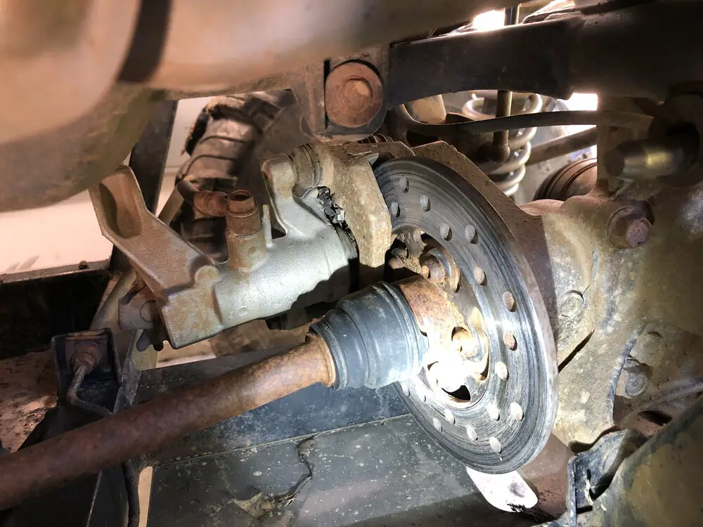

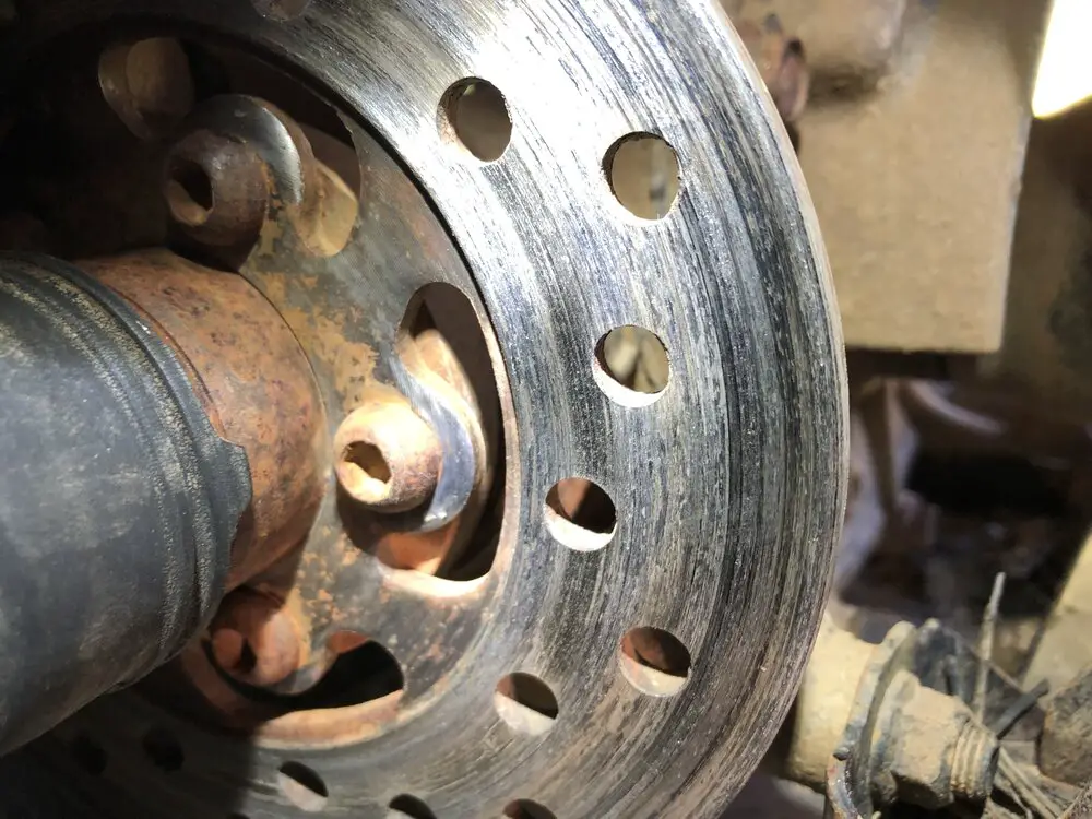

My 2014 also had rear brake issues over the weekend. Riding Buckhorn trails in NW Arkansas and about 9 miles into a 23 mile ride the brakes started sounding like pure metal to metal contact. It sounded like front left brake grinding and at the time was more concerned of getting it back to trailer than trail fix. It made the noise several times when brakes were not being applied so I was thinking major issues. Once home and washed off I drove on street and only when brake pressed did it grind. Sounds were coming from rear. I checked rear rotor and it was freshly gouged. I searched forum and found video from Youtube called "hillclimb and rear braking noise. It was exactly what I was hearing except mine sounded much louder but that may have been the 45 degree headed down a mountainside scared feeling. My question is how do you get the rear brake rotor off? I downloaded shop manual but it doesn't cover rotor removal only brake pad replace. Do you have to remove rear diff enough to get it off or does driveshaft slide somehow?
IMG 4062 IMG 4063
View attachment 263765 View attachment 263766
I’m not sure but I think you are correct. Pull the rear final drive and then the drive shaft should pull out. The rotor bolts to the shaft. 😎
