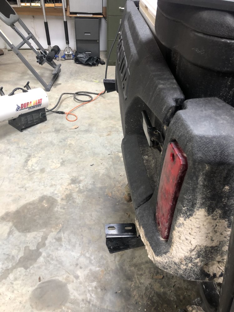

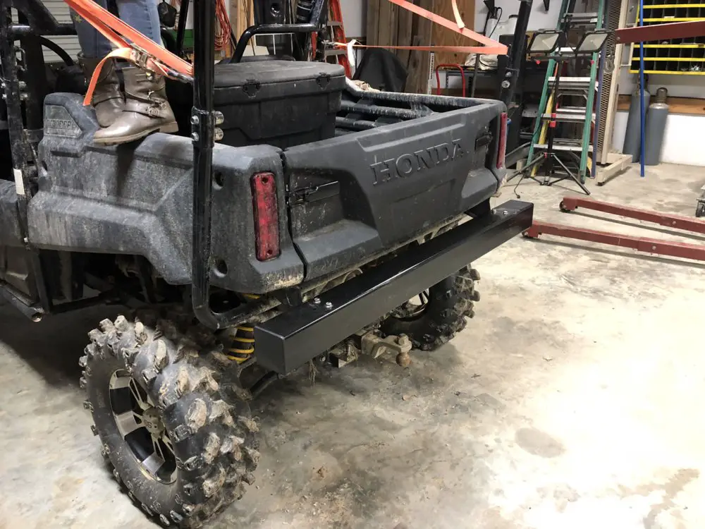

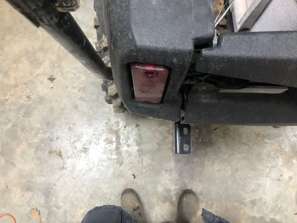

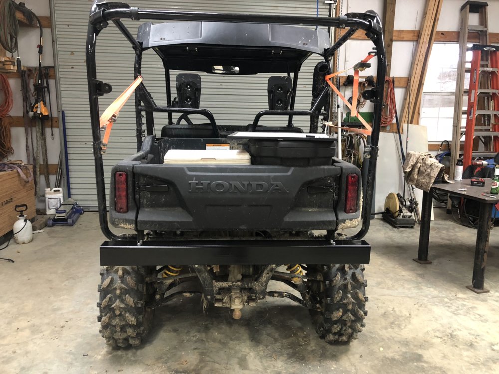

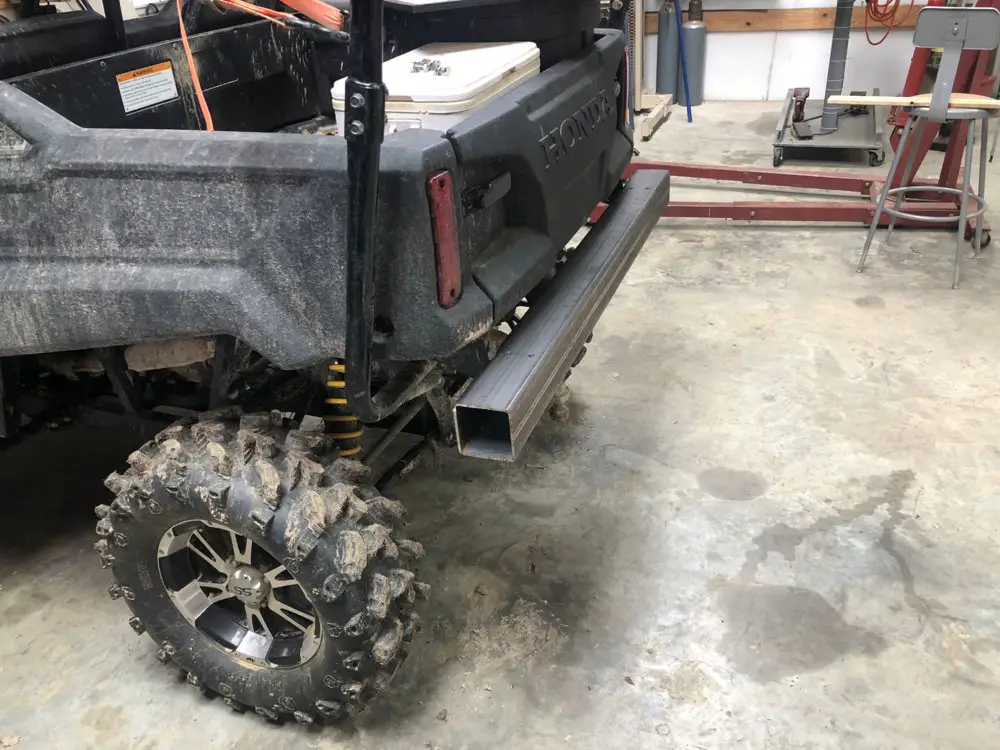

I bought the rear bumper brackets from EMP.
Cut a piece of 4x4sq tubing
Trimmed a relief for the brackets
Drilled the bolt holes
Painted it
Added the end caps.
1pic 2pic 3pic 4pic 5pic

Very nice. How and where did you connect the brackets to the machine? Pic? Where did you find the end caps? I also may steal this idea. Looks nice and beefy.
Gator
Gator
The Most Unknown Member
Sep 16, 2015
2,488
10,464
Louisiana
The EMP brackets come with instructions that are pretty easy to follow. They connect to the frame where the dump bed connects, and pivot with it.
I ordered the caps from Amazon. I'll add the link.
https://www.amazon.com/gp/product/B076GGBHDT/?tag=sxsweb24-20
I've considered welding a plate on the end and making it 100% water tight. Then I could cut it out to add recessed back-up lights or storage.
