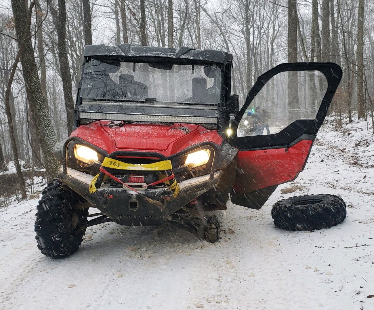

78425
The one time I didn't use lock tight on my spacers lol. It could have been half ass torqued but it made it all day before it finally fell off. I just use the blue stuff and never had a issue since.
Yeah u must have not torqued them.
technically you shouldn't have to use locite
On that. We dont on our regular lugs without spacers🤷🏻‍♂️🤣
I guess being a trades guy as Iam, its burned in me If you put Stuff on things that shouldn't be on in the first place if did your job right and the next guy has a hell of a time removing it makibg the hob take longer than it should you catch hell lol. Thats why I tell my apprentices, works smarter, not harder lol
