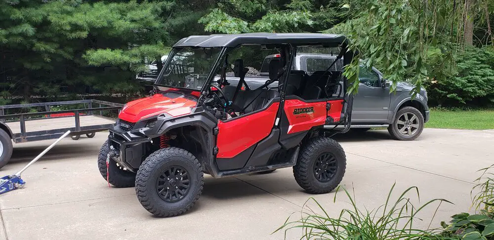

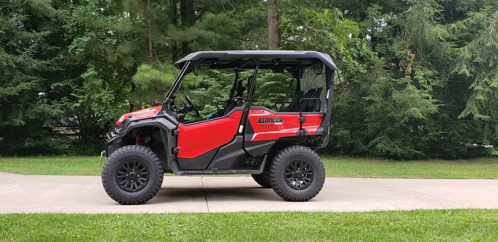

Just wanted to post some pics of my combo for anyone who's figuring out their build. 2018 Pioneer, SATV offset arms, fox shocks, 2022 deluxe wheels and 29" Mud Terrains, 9" front, 11" rear. Couldn't be happier, doesn't look like anything will rub, heading up north this weekend, will update when I get back

Looks good.

Looks good. During articulation your rear tires might rub the bottom of the doors but you can always add a little preload to make clearance.
I have Superatv arms with 30s and I've had rear door rub, rear roll cage rub and rub under my head lights.

For anyone whose wondering, no issues in the front, rear tires rubbed the roll cage twice all weekend (wasn't loaded down at all though) Going to space the wheels out 1 or 1.5 in and see how that does. Still really happy with the tires. much quieter on the pavement felt better on hard pack and didn't miss any traction on the trail.
Looks good you running spacers?
No spacers, had a little rub on the cage in back, going to space a little to try and get rid of that.

Check under the rear door pins. My tires rubbed there before rubbing on the rear lower bar of the roll cage.

Looks like the back end is sitting a little lower than the front in your photo’s. If you add spacers to the rear it will change the geometry and make it squat even more. You may want to go to non progressive springs on the rear to bring it up and get a better ride.
